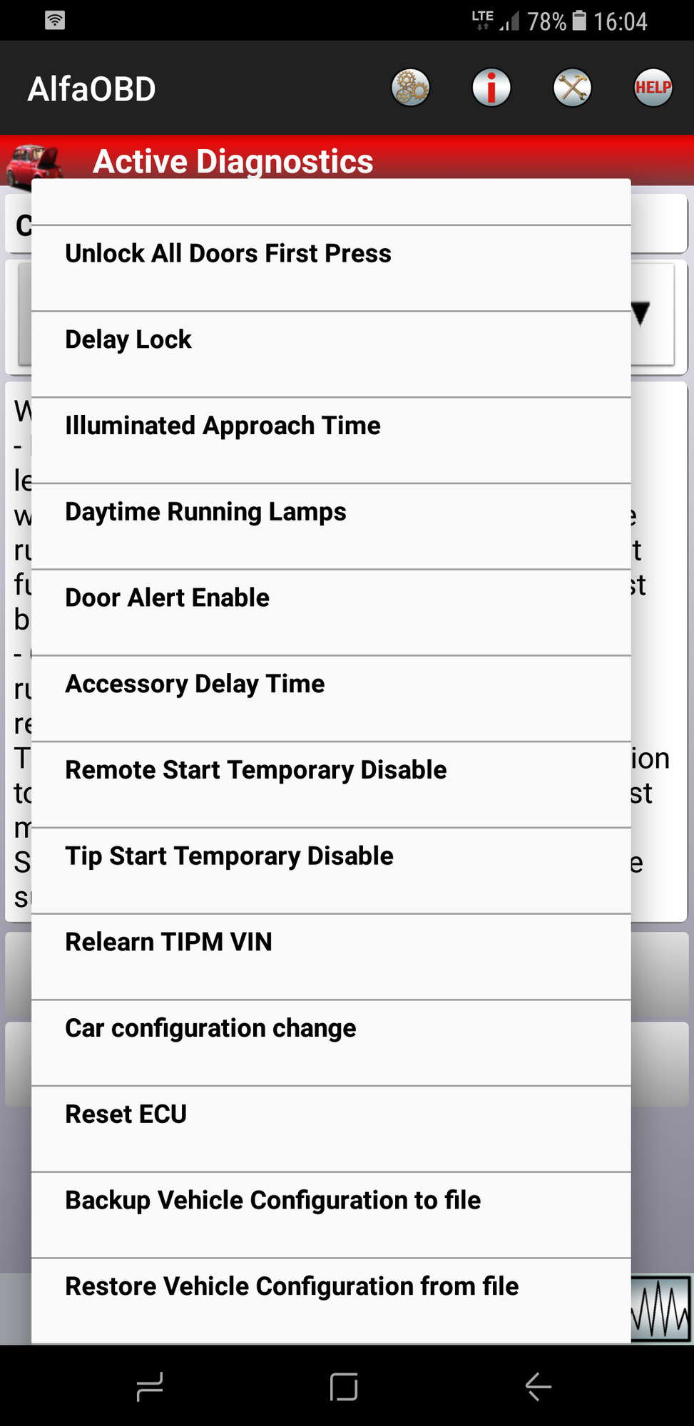

Here ya go:
When you get this far, go to the bottom tab and scroll all the way down to the last option an select MY2006-12 Non-PowerNet. at the next screen select connect.
After you're connected, tap on the small car icon at the bottom right of the screen and you'll see this pop up. scroll all the way down the bottom and select Car configuration change.
Tap select option and this will pop up. Select cruise feature.
Change the value to Set and then tap Start. If all goes well, you'll see a notification that the changes were successful.

After you made the changes, you should verify they were successful by turning off the key and start over. Once you get connected again, just cruise through the menus again and make sure the item is still showing set. It will look like the second to last picture if everything went alright.
