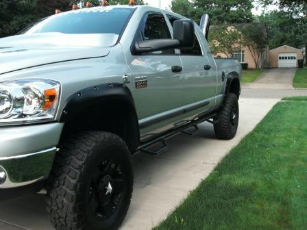

I Have A 6.7 Running H&s Race Tuner At120 Hp Tune Was Told I Need A Transmission Upgrade To Go To The 175hp Tune And A 225 Hp Tune
Wow What A Change In A Truck .anyone Know What Should Do Or A Good Replacement Trans
