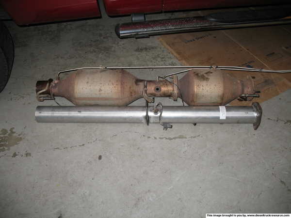

The DPF/Cat removal was as easy as getting the delete pipe and picking up the Smarty. My average tank mileage is up to around 18.5 mpg from 14.2 with it in "Stock" or running the Smarty for a stock truck. Highway clear runs only can crest over 19 mpg. The pipe is on the shelf should I ever need it.

But this is the $64,000 question, if you did have emissions issues that needed warranty work, and they did look and find the 'EGR Fail' messages, would they honor the warranty work? Thats the main concern I have.
Thanks for posting that picture and your input!
I see you finally did the exhaust Lil Dog. Mine looks like that too as of last month and is on the shelf if needed as well.
Looks like you got the same pipe I did? From Pro-Flow? I kept that O2 sensor in the stock pipe and put a plug in the new pipe. Had to cut down a metric bolt. That was the easy part though. Had a bit of trouble getting the delete pipe into the pipe going to the muffler. Got it done though.
Thanks... Yup Flo-pro pipe as I had researched. I didn't have a 1/2" NPT pipe plug tap to take out the 18mm sparkplug thread for the O2 sensor, so I thought it was a good plug in the old system, should work fine.
