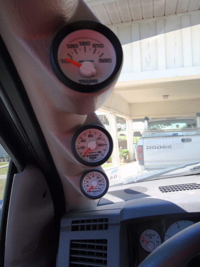

Dont forget some type of gauges or electronic monitor. I have a set of Autometer "Factory Matched" gauges, EGT, Boost, Tranny Temp. Can post up pics if you like. The Edge Insight is also a great electronic option.

Here are a couple of shots of the gauges, dead on match for the factory, and they are Autometer so quality too.
