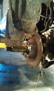

Ok, Sorry It has taken so long to post my progress & pics. I installed this kit within a 2 weeks of receiving. I did ask for assistance from my rearend builder @ work.
This is the only kit I have had any direct contact with, but from my experience with selling new & used replacement part. I feel it is a very solid & long lasting conversion. Plus, It is all serviceable.
Remove wheel, oem caliper & rotor. We did have to heat the bolts to remove hub.

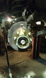

Hub & dust shield removed, with factory stub shaft.

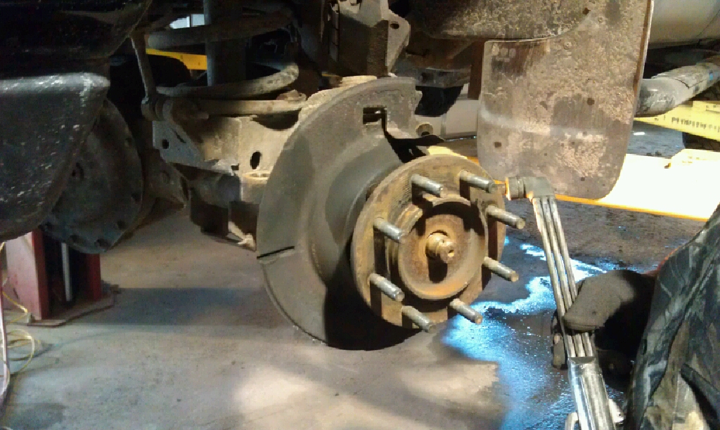

Inner & outer axle removed.

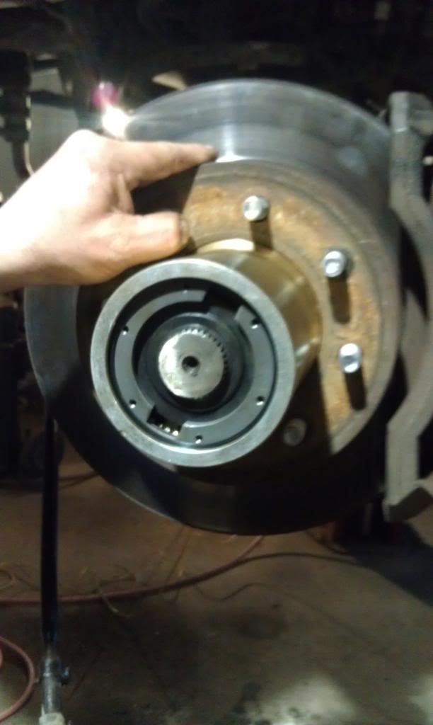

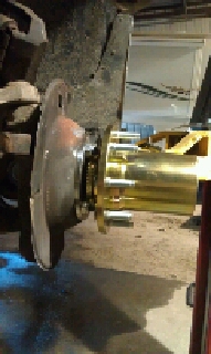

Replacement hub, with abs reluctor wheel
Rotor, caliper & Internals installed before lockout cap.

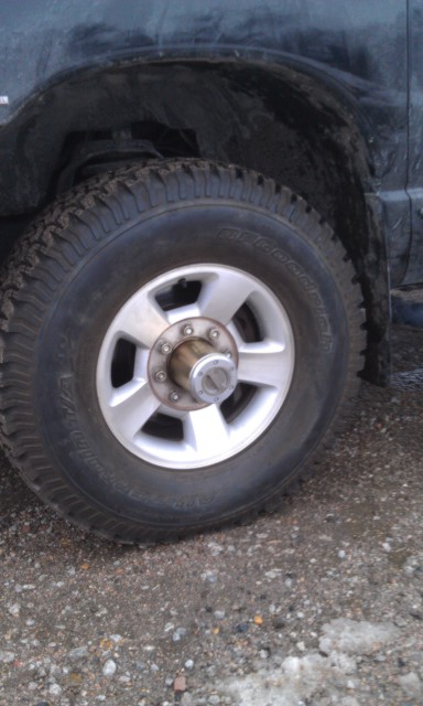

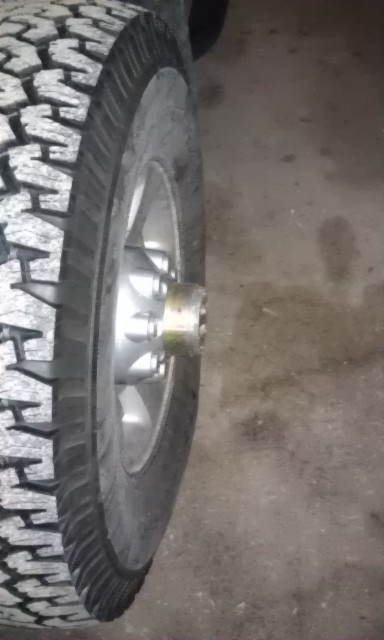

Lockout Cap installed , With wheel, wo- center cap
Factory wheel with modified cap.
