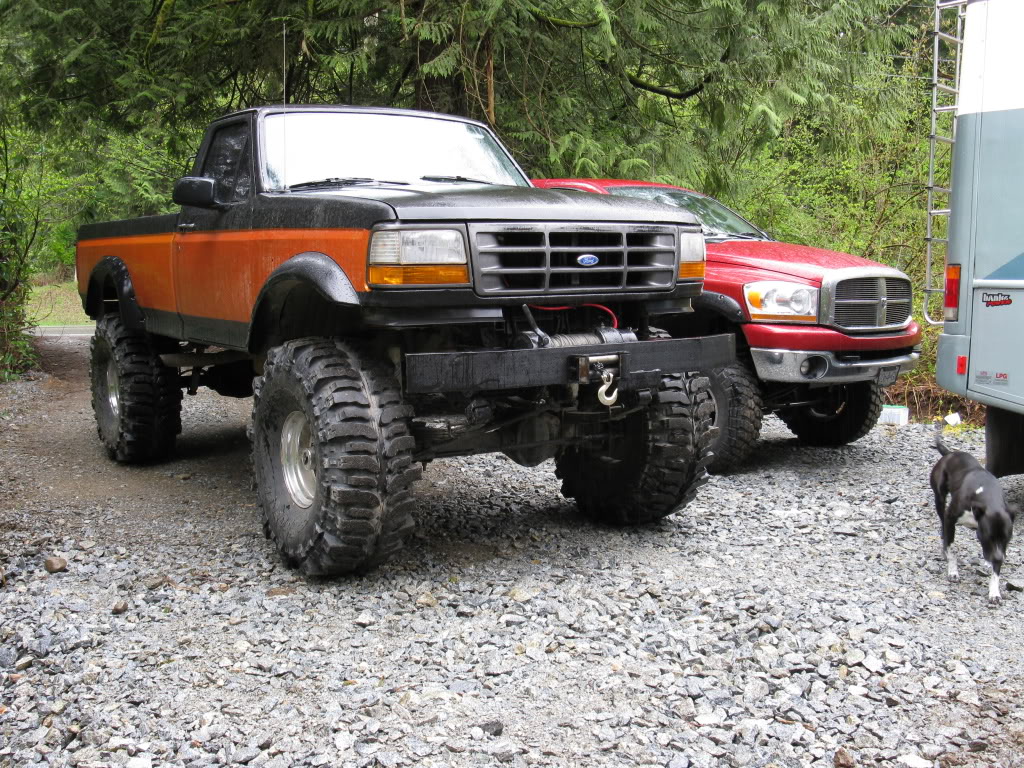

I do blame dodge because I think the parts they use in their steering are undersized for the weight of the trucks. In fact I think their whole front end is crap.
Yes my truck is raised and modified, but I've been building 4x4's for 15 years now. I know how to correctly install lifts, modify suspension, gain correct steering angles.
Take for instance the ford I have right now. It's a 95 F350 with a 6" suspenion and 3" body lift and 44" tires. I take it off road and thrash it. It's built for mudding. If a tie rod end was going to fail it should be on that. But they hold up.

Cool truck!!
