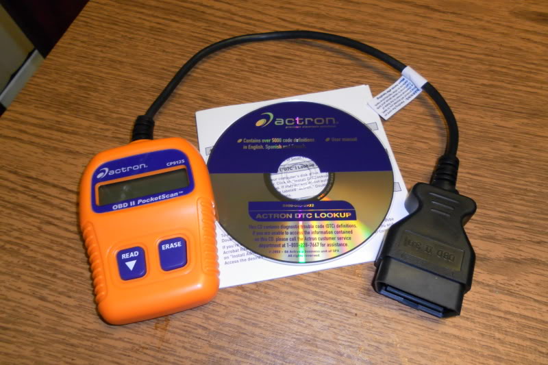

i had 1 code already from the injector issues that have been fixed, today i changed the oil and had the air intake off from the air cleaner to the turbo, OOPS i started it and the check engine came on because the cold air sensor was unplugged. now i have 3 codes, 1 from the injector issues, 2 from the sensor unplugged.
i was at Sears today and bought this for $49
it works, cleared the codes.
it came with a book for codes and this CD
kinda looks like the one above for $17.49
around here the stores will check your codes but will not clear them.
