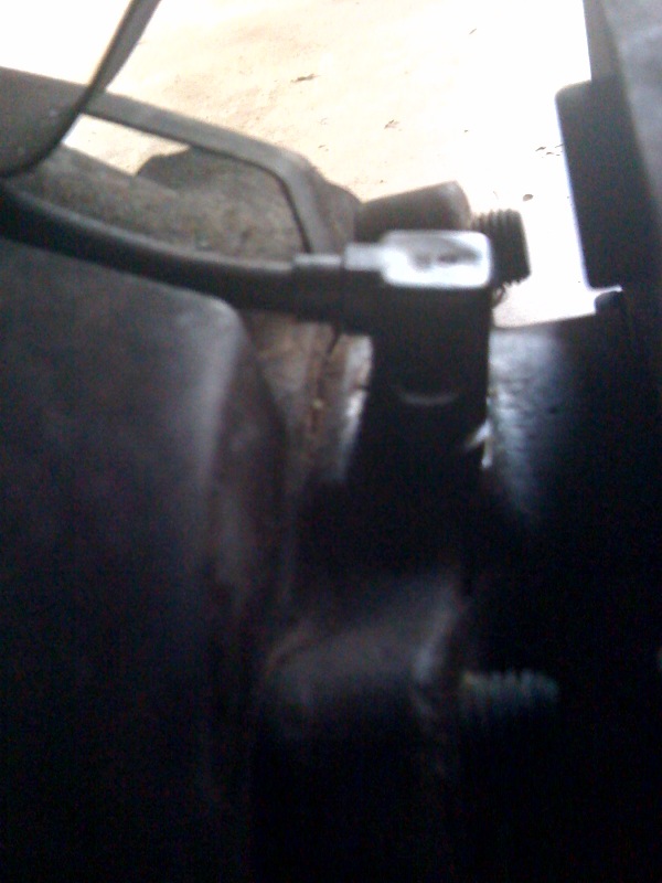

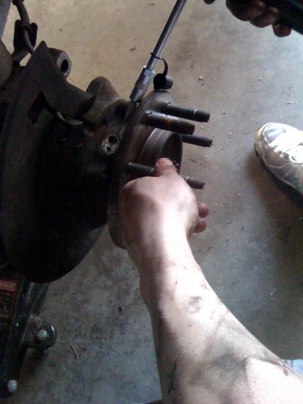

This worked like a champ. I had a little squeek coming from my driver side bearing on my 3500 4x4. I pulled it apart and followed the directions given on page 3 of this thread and it solved my problem. i have a couple pics I took as I had noticed there were several requests on here for some pics of the process.
Great idea, thanks for everyone contributing to saving my bearings and my money.
