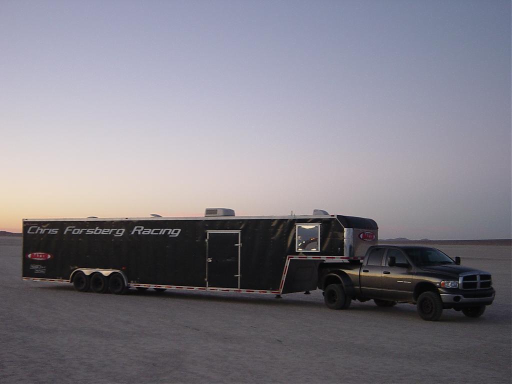

It is a shortbed. Thats why I bought the megacab fenders. They have the cutout for the gas door and everything. The whole conversion would be around $2000 if you went the route I went.
This is the best sideshot that i have of it. That was the trailer i used to tow with it.
