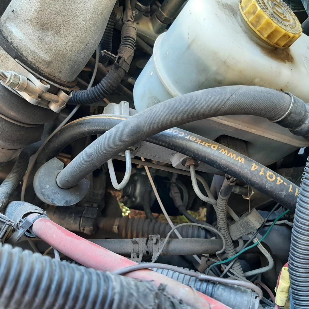

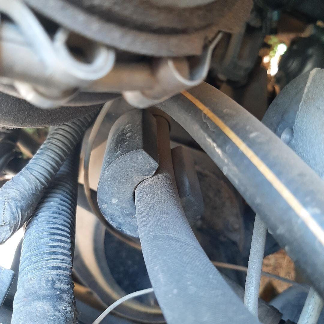

On the early gen 3 there was a similar issue and the fix was a large dampener weight clamped midway up the booster hose. Not sure how this was done, but seem to remember that there was either a service bulletin or letter put out by Dodge. My truck has this dampener weight and it was installed free of charge by Dodge. Perhaps your truck can have the problem rectified the same way?

Photo ?
Could you please send me a photo of what your booster line dampener looks like plus showing where it is located on the booster line

The damper is almost hidden, so it was difficult to take a decent picture. Hope these two pictures help in some small way
