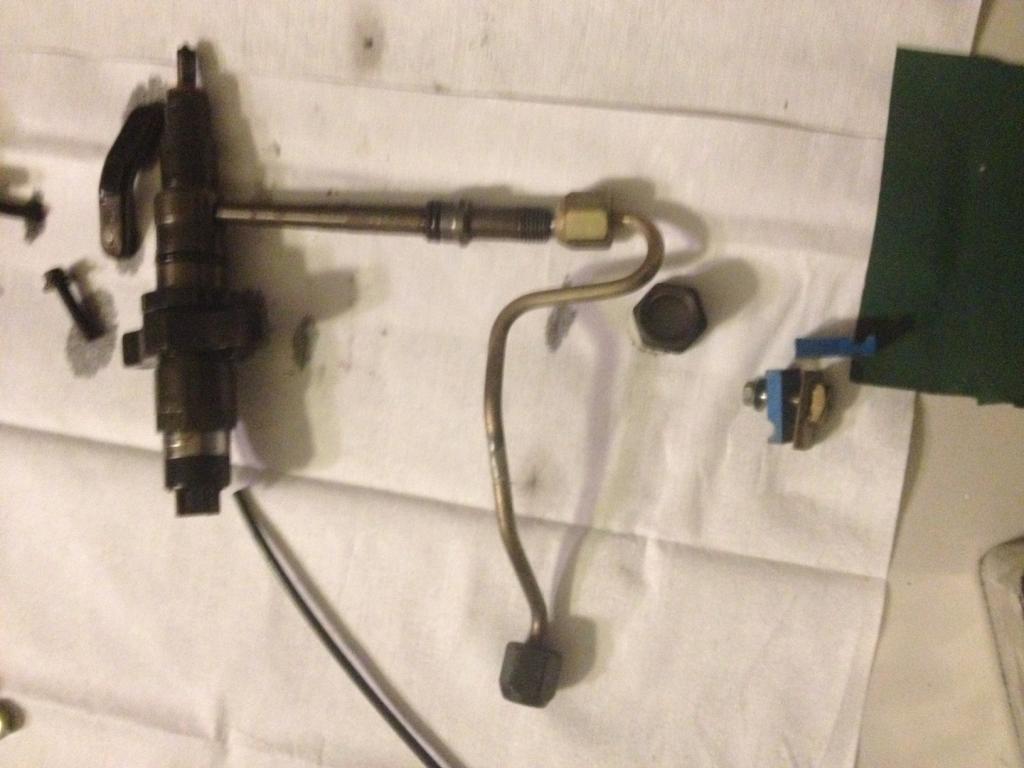

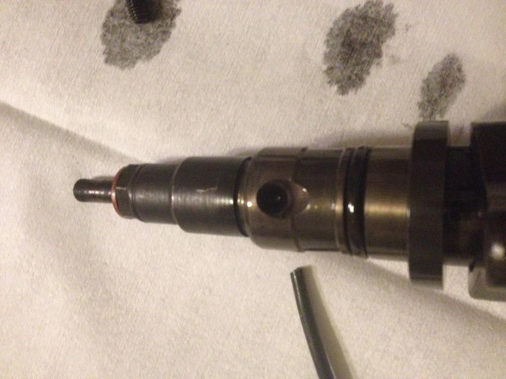

The line that comes off the rail connects to the injector tube, that seats into the injector. I'll go take a few pics of the setup in a few minutes...

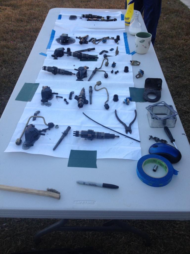

So, all of the lines were tight, so the injectors are out and I have to call Don M on Monday... looks like I'm driving the OL's truck for a while Anyone have an extra vehicle I can borrow for a few weeks?

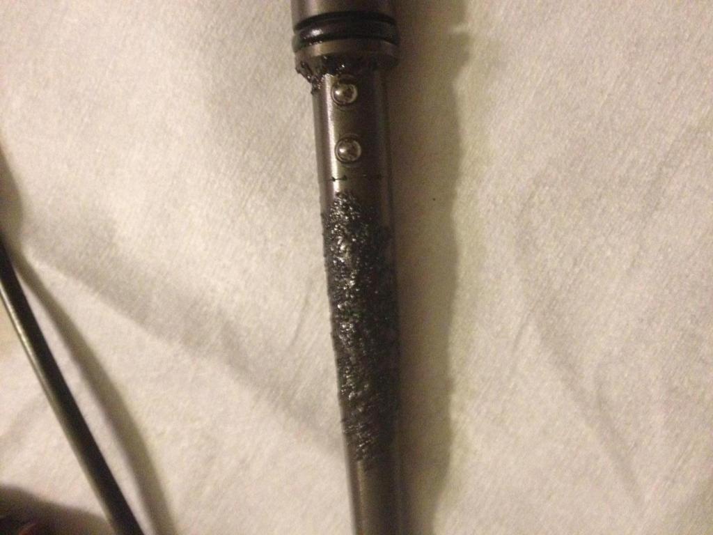

I noticed rust on the connector tube... is this normal? All of the tips had carbon build up on them, no injector looked different than the other. I cranked the truck with the valve cover off, everything looked normal from the top- I have been told that you may see a fine mist at the top of a bad injector if the top half is bad...

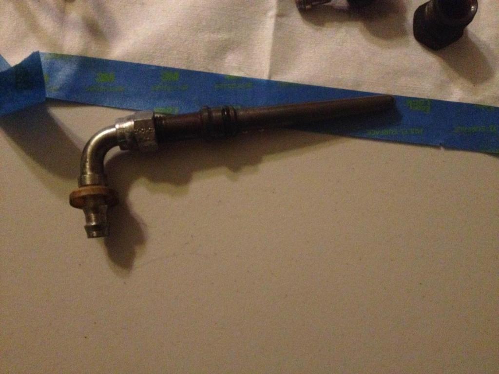

I also discovered a cheap replacement for an injector connector tube removal tool... It is one of the fuel line connectors from my walbro fuel pump with 3/8 fuel lines, I think...
