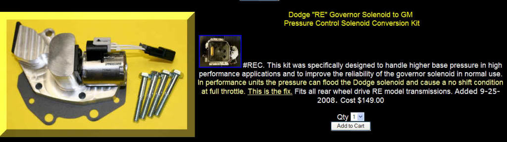

When changing the transmission fluid on the 04.5 is there a drain plug for the torque convertor. Also, I see the TSB for the Governor Pressure Solenoid Valve, as discussed in other threads, where can this be purchased other than the dealer. Dealer price here for part # 04617210 is $144.00.

No drain plug for the TC, most just pull the rear cooler line and route it into a contanier. Run in neutral until flow drops, fill trans and repeat until fluid looks good.
OEM solenoid, transducer there also:
http://www.transmissionpartsusa.com/...-000053396.htm
Upgrade:
http://www.transmissioncenter.net/dodge.htm
