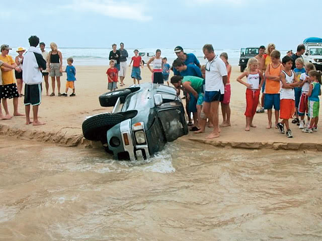

Beach sand conditions change depending on the weather/tide. I have seen the beach change from hard packed sand barely needing 4wd to soft sugar in 24 hours. The sugar sand fills in behind your tires as you go. 2wd will never work in this stuff unless you never stop moving. Aired-down tires and smooth throttle inputs will get you almost anywhere you want to go. If you are axle hopping around, you are doing something wrong. Stay away from the tidal pools/streams on the beach. Driving directly in salt water is a bad idea and you do not know what the sand is like under the water. Also, watch out for debris washed up on the beach. Following a set of existing tire tracks makes it easy to avoid running over stuff. Make sure that you rinse off your truck completely when you get home from vacation. The consequences of getting stuck on the beach can be high:

Nasty Picture .. Probably a foolish driver. I have driven a Jeep 4WD and a Suburban 4WD both gassers and both in 4 WD High on the sand and never had any axel wrap / wheel hop problems or got close to being stuck. I beleive the wheel hop is because of the additional tourge of the CTD, Your Timbrens may be the difference between our trucks preformance on the sand I have stock suspension. I have thought about getting traction bars though.

Seeing that picture makes it hard to believe that the sands of Daytona Beach were once used to set land speed records of over 200MPH...Tire pressures then were around 125PSI......Ben
