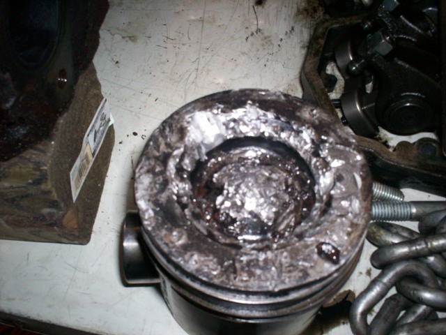

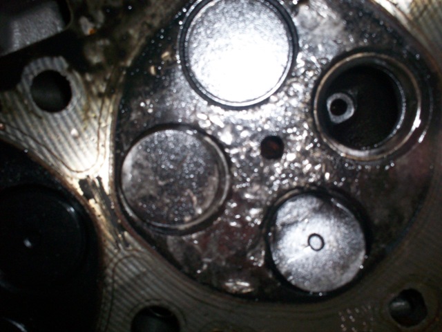

This was my slight tic...Hope your luck is better then mine was...
Attached Thumbnails tic in motor-cummins-carnage-013.jpg   tic in motor-cummins-carnage-021.jpg

Zoikes! Looks pretty scary. Mega bucks too.

All in the quest for power...

Hey Billie it was just a tic tic tic... Well before it went BANG BANG BANG....
Sorry 39b just messin with ya.
