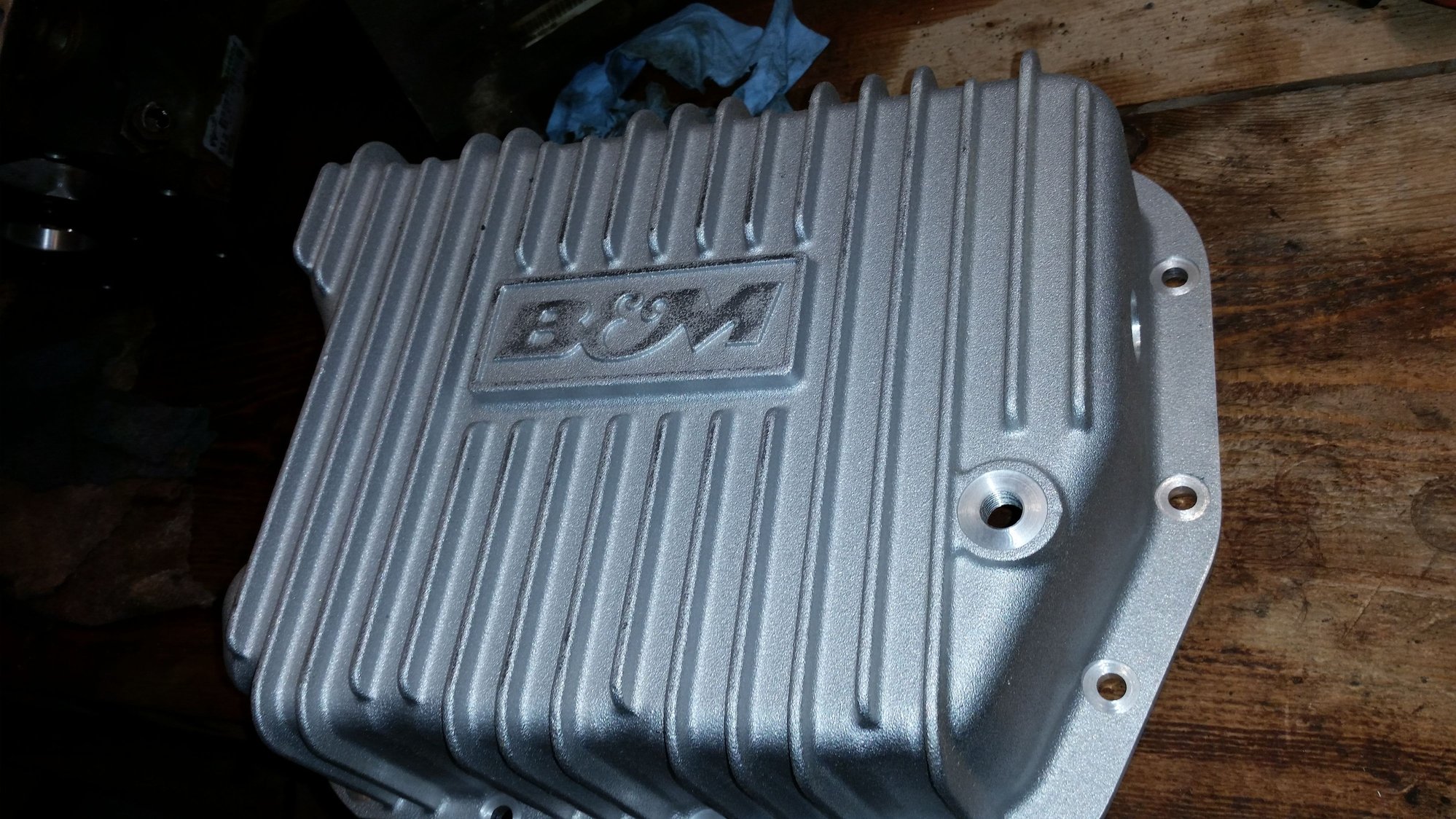

New pan, $112 from advance auto plus $20 in perk rewards to go towards buying atf+ that they dont allow a discount on.

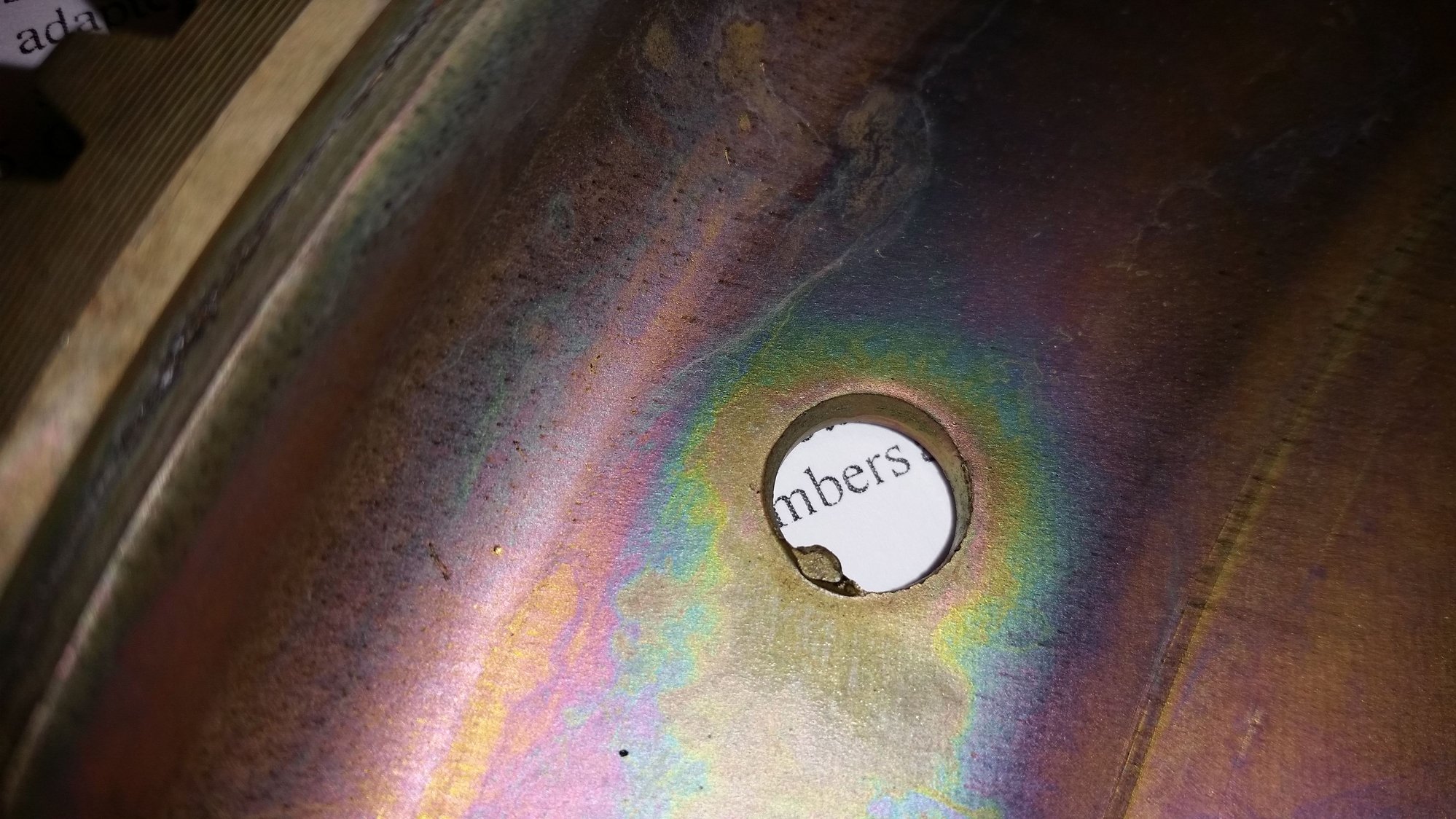

Several burs on the bolt holes.

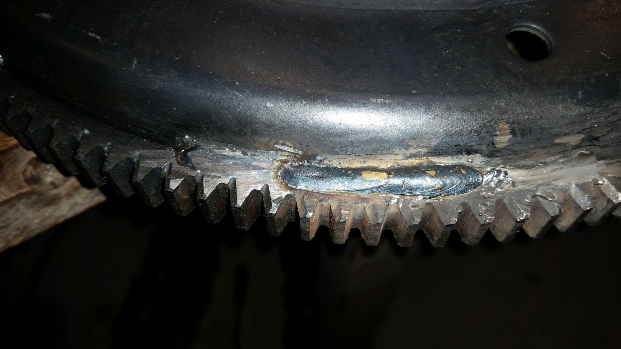

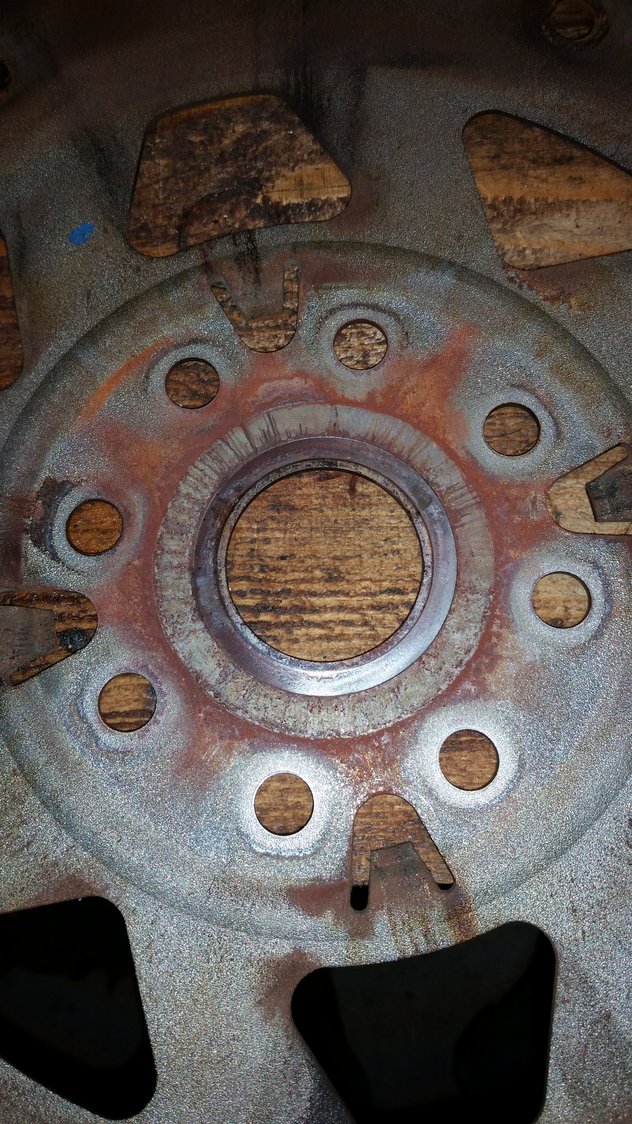

Certification sticker was neat at first but then i found the burs and weld. Still better than the flexplate from advance auto
ATP flexplate, returning it to advance auto. Thought it was tge same as the sfi plate. Unreal how bad it was
