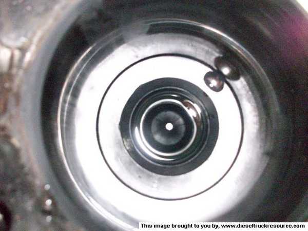

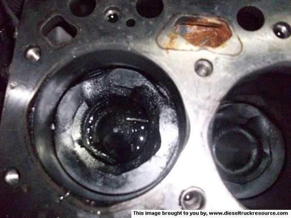

Take a look at pistons and tell me what caused
it to happen.
I always knew I would burn a piston or two. I was prepared for it - no big deal. But what i dont understand is that every piston has damage. 6 is worst, then 5 through 1 damage diminshing. Is the burnt pattern from the nozzle spray pattern. Originally I thought maybe the valves hitting the pistons started the process b/c of the half round on number 1 you can barely see it...but I have Sportsman springs.
I just dont get all 6.
Also some pics still waiting approval this pic is number 3
this pic is piston 1 notice the half round spot barely visible
Number 6 is the worst

I have personal opinions on what did it, but I'm probably wrong... I'd say that Edge has a lot to do with it. When I had mine, EGT's were always off the charts. That, coupled with those big sticks and a big single... Man, I bet that thing stays warm.

Do you have any water on the truck? Do they allow a water system in your class of pulls?
What really happens is the pistons aluminum softens over repeated cycles in the area the fuel does not spray. Once the softening starts in this region it moves to the area the sprays do contact. Overwhelming the cooling effect of the sprayed fuel. If the pistons get hot enough, the sprays can begin to erode the aluminum away and melting is what you see.
Water can really help to alleviate this problem of hot piston areas. The botton line is heat on the pistons crown that kills them.
If you have water, more turbo is the next step. Its all about heat control.

More timing adds cylinder heat, but reduces EGT. EGT is the result of more unburned fuel from the earliest times of combustion. Added timing can actually add to your problem of too much cylinder heat, not take it away.

Porting will not help much, IMO. Finding a head from an 06 and up would though. The ports are mucho better VS the older engines.
Water will lower the crown temps for certain and should be the end of the heat problems. Just make sure it is always working before you start the pulls. Go easy on methanol if you feel you need some for colder temps. Dont exceed 10%, IMO. Were you pulling when the failures happened? Was it knocking before you stopped the engine?

Dan, if you're pulling with just the mods in your sig ( and I'm no puller) I think you need some water at a minimum, at least a 4 nozzle job, and get rid of that edge. I'm not here to bash the edge, but the way that they make power is timing and dumping fuel in the cylinders. It was a great box for me until I added an aftermarket turbo and sticks. I have an edge vs smarty thread around here somewhere... look it up.
I will be happy to mail you my smarty once you get your truck back together and let you try it out. Just send it back, or I will have to come for you...
You will really see the difference.
If you are a serious puller, I would look at some coated pistons, maybe a lower compression ratio. (again, not a diesel guru.) Build the truck for what you are doing...

This is an UNEDUCATED guess. But to me it looks like some of those pistons were getting fuel sprayed on top of them instead of in the bowl where it belongs. And yes I would go through the springs and measure each one for consistency. There is a tool for that, and I can't call the proper name of it, but you will squeeze each spring down and it measures the resistance the spring provides.
