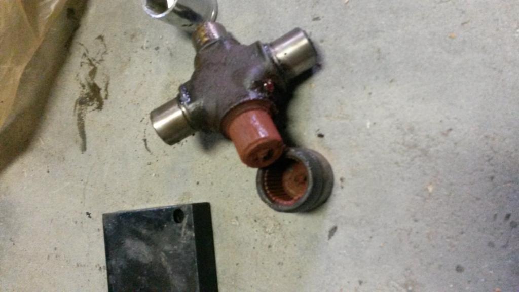

Old May 13, 2015 | 02:28 AM
Adaminak's Avatar
Posts: 616
From: Charleston, SC
Thanks for the info on the P/S pump pressure. Sorry for the delay, but I figured I'd let y'all know I found my culprit. Driver's front axle u-joint was toast. It looks almost like it wasn't properly greased after initial installation, and a piece of junk got in and plugged one of the grease tubes. Oh well...at least the hub will be easier to take out when it goes bad in a few months
