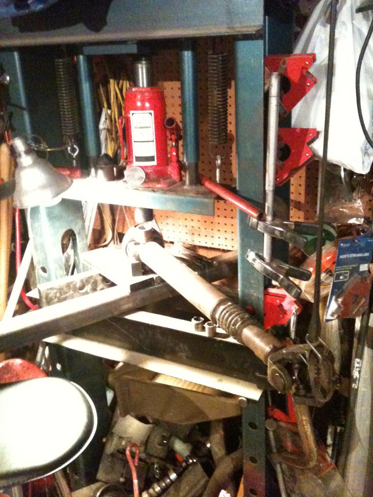

Here are some more pics... first the press I use to remove the joints and a trick I do when Im working alone, I hang the one end from the ceiling.
