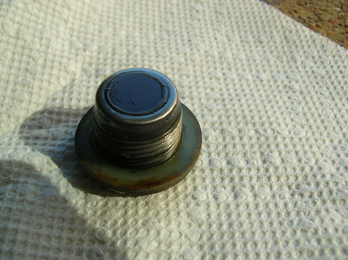

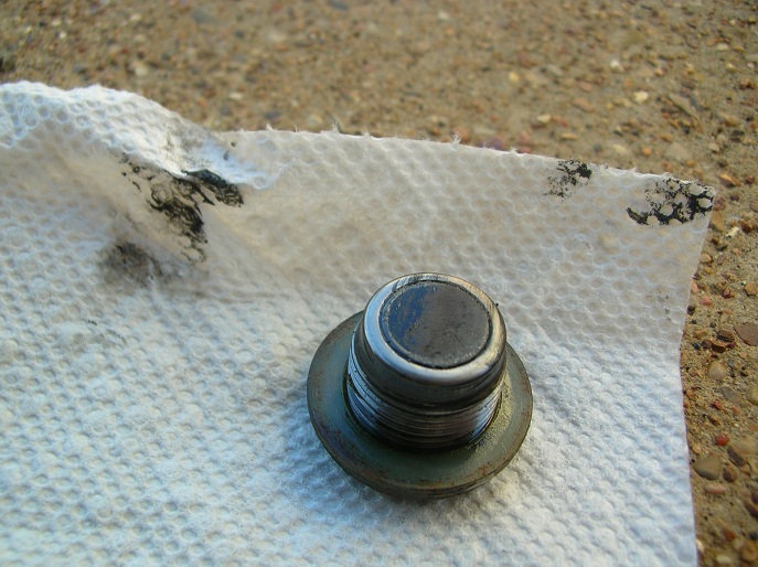

Pulled the plug and it really had nothing on the magnet but I park the truck on an incline so the fluid level doesn't rest level (away from plug). Any possibility that affects what sticks to the magnet?
I think I better go get some more diff fluid and pull the cover off. Not knowing because I won't pull the cover is dumb. Can I pull it into and out of the garage (level floor) or should I not move it at all?
So, go with 140 then? Spring & summer are around the corner.

Nah! The incline should not affect the ferrous material stuck to the magnet at all. If is sticks..it's stuck there. Good idea to pull the cover for a look and change to the Mobil 1 75w/140 is a good idea as well.
Also, pinion bearings tend to whir, rather than rumble, because the pinion is turning several times faster (depending on gear ratio) than the carrier. We recently had pinion bearings replaced in a company Dodge CTD that ran low on fluid from a seal that blew out over a the course of 750 miles. However, the picture you show looks a if this just occurred recently. I would change the fluid and proceed from there as I doubt that the pinion bearings were compromised.
