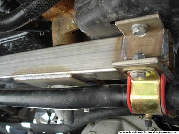

Do you have pics of the sway bar and trac bar mods?

These are all I have right now:

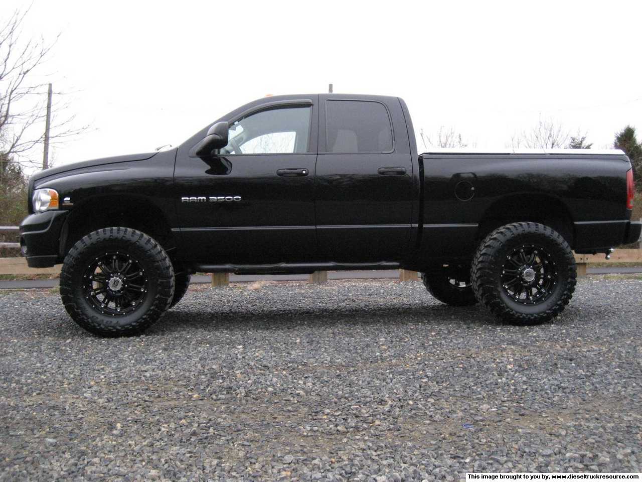

XLR8R nice job and nice results. I don't know how you did it but I had to put in a 4.5" Tuff Country lift with my 37's and I actually have the correct rims, 20x9 with 6" backspace. I couldn't have done it without the lift. Even with the lift I had rubbing in the front and had to trim the front chin spoiler. No rubbing at all by the fender though. Also I have 4.10 gears but have not been able to calculate mileage yet since I haven't had my computer adjusted yet for the bigger tires. It is way off, the other day I got pulled over for doing 68 in a 55 and the speedo was on 58 or so!!! The cop was cool though he let me slide since I was honest with him and not trying to make up a story.
Here is my setup
Thanks!
Looks like your lift came with longer lower control arms, so that's why your tires clear the rear wheelwell and took a "bite" out of the chin spoiler.
Nice truck

Thanks for the compliments guys.
I didn't mean to hijack the thread, just wanted to show the difference with a 4.5 lift and same tires compared to XLR8R's setup.
