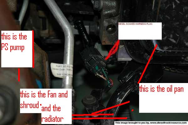

Well I crawled under my truck today and sure enough MY CP3 is leaking!!
I tried to take some shot's of it but they did not turn out very clear.

53 ******,
Yours doesn't look like it's leaking too bad yet compared to a lot I have seen. If it gets real cold there in Utah it will get worse in time. If it ain't hittin' the ground DC won't replace it. Just keep an eye on it.
it's been below freezing for a little over 2 weeks here in Utah.
it's leaking pretty bad,(the pic makes it hard to tell how bad it is.) if I move the harness over a little it will leave a spot on the ground.
I have an appointment for the 14th so we will see.
that's so stupid if they wont replace it it's going to ruin the harness with diesel running over it all the time.

53 willys's Avatar
Posts: 6,259
From: Utah
the leak is on the front drivers side of the engine it leaks down on the fan clutch wiring harness look up between the power steering pump and the oil pan and you should see it....my buddy has an 05 and he checked his and his is leaking also...
Old Feb 18, 2007 | 10:24 PM
53 willys's Avatar
Posts: 6,259
From: Utah
this may help more or just confuse you guys more but here you go anyway
