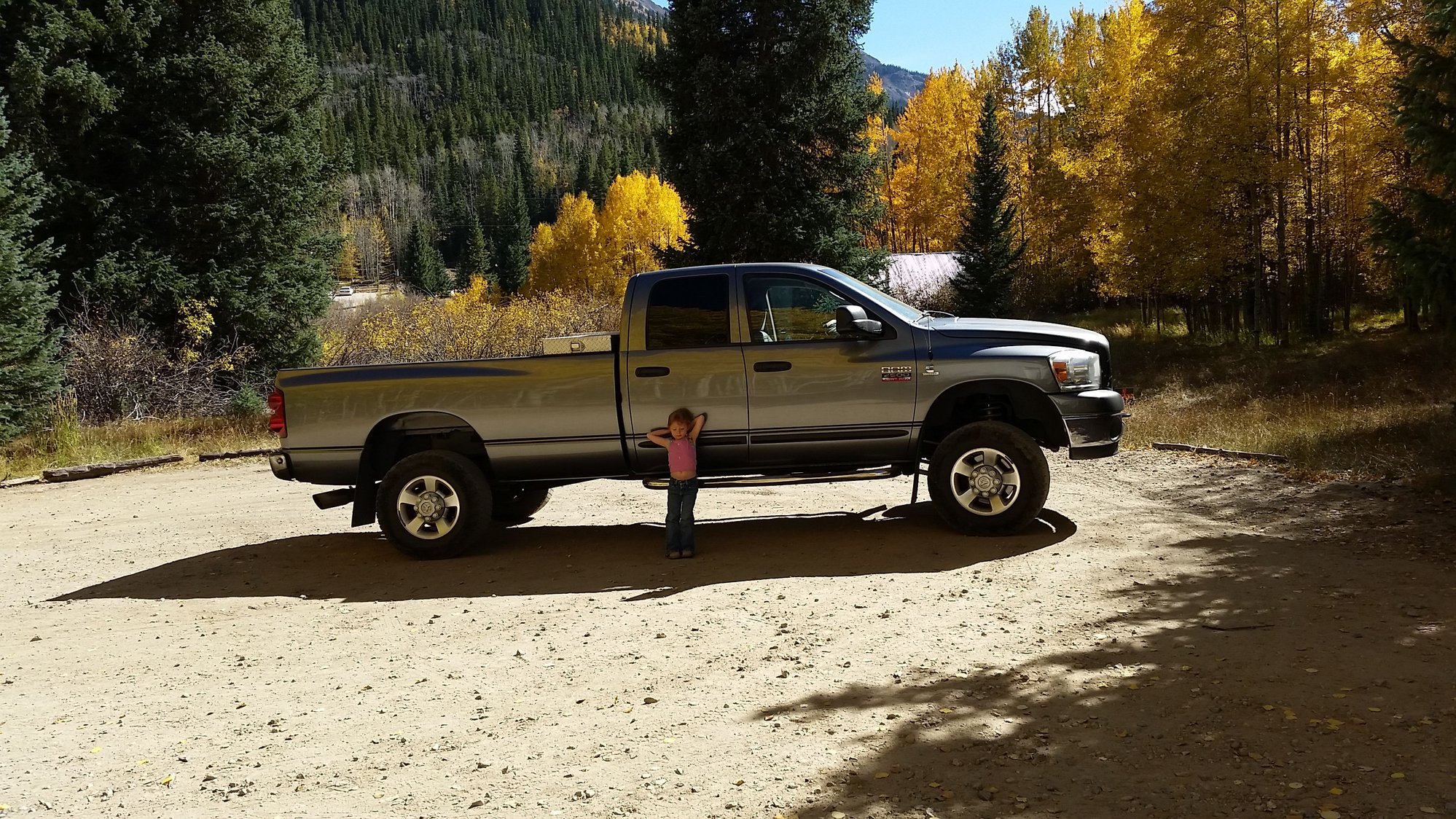

Hey Guys-I desperately need some help from you Cummins folk. Long read, but please bear with me. My truck in picture
07 5.9. Bone stock when I bought it. Immediately put tunes from ATP, a CTS for gauges, a Cool Tube, and a 2 micron fuel filter/water separator from dieselfuelfilterkits. com.
Bought the truck with 163k on the clock last summer-no noticeable blow-by. Now has 183k on the clock.
