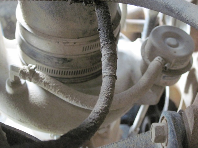

If you are seeing 28psi then someone has already worked on your turbo, and you probably have a boost fooler.. If you don't have a boost fooler then you could be defueling, without a code... 1000* does seem very low.
Take a pic of the turbo and of the elbow where the WG gets its air.

Here are the pics. No codes when I bought the truck, I will pull them again to be sure.
Attached Thumbnails New to me 03, low on power or is this normal?-turbo-2.jpg   New to me 03, low on power or is this normal?-turbo-3.jpg   New to me 03, low on power or is this normal?-turbo-4.jpg
