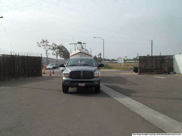

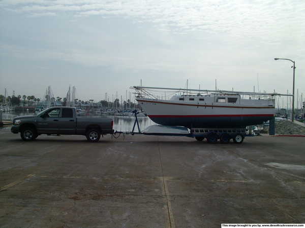

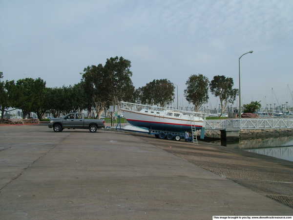

My truck weighs roughly 7100-7200lbs with fuel and oil only, so there's you a reference. If you want to know if my truck will pull 12K, here are a few pictures for you. It's only 10K, but back home we pull our 13K goosenecks full of cattle regularly, and the trucks do JUST FINE.
Weight is on the receiver, rather than a gooseneck or 5th wheel, and the truck is level...pulled it just fine.
