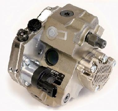

I am needing to check the FCA, and the MAP sensor, stupid questions and lack of time at the moment lead me to ask this.. ONe where is the map sensor on my truck? and two, the FCA as well.. pics will certainly help please...

The Map sensor is between the #3 and #4 injector lines. But if it were faulty, it would throw a code and send the truck into limp mode.
The FCA is on the back of the CP3, as shown in the pic. But BE CAREFUL!! The screws might be corroded in place, and the risk of stripping them is high.

aahhhh gotcha.. thanks for the help on this one... nah the truck throws no codes and does not go into limp mode...
FCA... is there a way to check it? and do i have the right part number?
