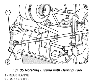

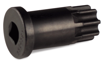

Have you seen if the hole lines up? That is actually the pilot for the Cummins barring tool, and should be outboard of any bolts, as it should be roughly 1/2" outside of the actual ring gear. It is used to turn the engine over manually with what is called a barring tool.

Through the barring tool hole? How the heck can that be.......

Its not a barring hope he's talking about. a tin access cover for reaching the flex plate bolts, just above the pan rail, on the right rear. Take the top bolt loose, take the bottom bolt loose, and the plate swings out of the way to allow access.
Just like...that
