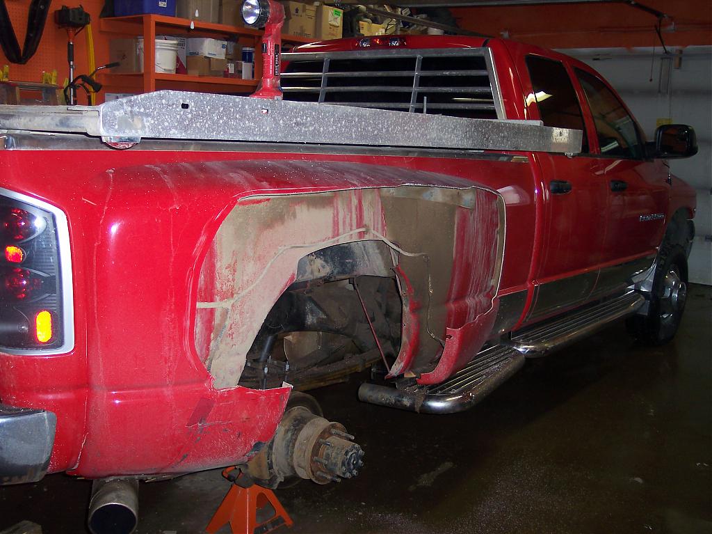

I had my dually fenders off before and saw that the body is actually cut out a bit on the stock fender. I think a set of bushwacker fender flares would cover it though. Maybe forget swapping everything out and just go for fender flares, regular stock rims and remove the hub extension on the front?
Could be cheaper and would retain warranty? Put that extra money towards a lift and big tires?
