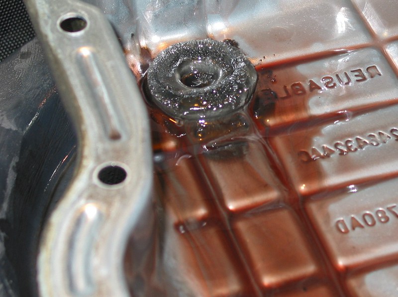

I replaced the gov. solenoid, pressure switch, and filter today. I was surprised at the amount of gray sludge I found. Is this normal wear.
The truck has 50k miles and I had the trans fluid replaced at 30k miles. This is the original filter with 50k miles.
BTW, the light throttle shift is perfect now.

I am doing this same deal this weekend. My Gov sol and switch have tossed codes for the past 6 weeks or so. The black stuff is clutch material and looks fairly normal based on what I have seen in other transmissions. This is why I never recommend to anyone to get a trans "Flush". It just pushes all that garbage through the entire trans.

My filter did not have that much on it, but the pile around the magnet was about the same I had. I have changed mine 2 times (I'm at 46k) and both time I had metal.
Edit: Actually after looking closer at the secind pict. Mine seemed to be more fine than yours. Do you haul very heavy?

I will say typical. I had similar metal on the magnet at 20K but almost none at 40K so most of those fines are break in debris.

i had same thing at 20k on magnet and pan....

I just did my 3rd change at 60,000 and I had the really fine powder type on my magnet, nothing on the filter. I can't remember the first change if I had those big chunks of metal on my magnet. Those are kind of large shavings. Maybe I had them... I did the first change at about 6,000 miles.

There were no big chunks or anything that felt gritty. The camera flash makes it look like metal chunks. It felt like sludge. At 30k the dealer said a filter change was not necessary. I bit my lip and said ok. I think I'd be better off changing the filter myself every 30k and top off the fluid.
