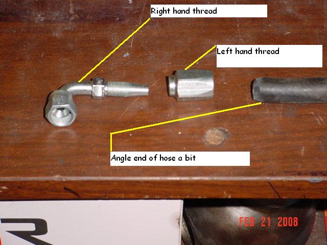

Not that hard to make up your own lines with the screw together fittings, I made all the lines on my rock crawler for the full-hydro steering. Did this a couple of years ago and they do not leak at all. I picked up the fittings and hose from PSC Motorsports but you should be able to pick them up at a hydraulic shop.
http://www.pscmotorsports.com/index.php
