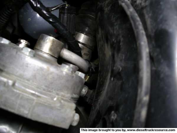

Originally Posted by bohdey
i just performed this to my '06 mega. i repl. the solenoid and pressure sensor and filter. it fixed the shutter, but my tranny is still shifting out of 2nd at 2500 rpm, too high. i talked to trans. shop and they think maybe bands. i think modified valve body should work.
I have been collecting info from old threads and think this might help you.
Note #2
QUICK RECAP....
AC HARNESS vs. ALUMINUM AC TUBE
SEE PHOTO 23858AC_Pressure_Switch_Wire_Issue
TRANS HARNESS vs. GROUND STRAP
Auto Trans hanging intermittently in 2nd gear - Trace trans harness to where it passes the ground strap... check for short or chafing.
STARTER WIRE vs. STARTER BRACKET
No-start condition - From driver side wheel well - Trace yellow wire from the starter as it passes the starter bracket... check for chafing.
BATTERY CABLE vs. INTAKE HEATER RELAY BRACKET
Check alternator/battery cable (between the battery & air filter box) where the alt/bat cable passes the steel bracket of the heater relay... check for short or chafing.
CROSS OVER BATTERY CABLE vs. AIR BOX PIPE CONNECTION
Check the crossover battery cable where it passes by the pipe and air box connection... check for short or chafing.
