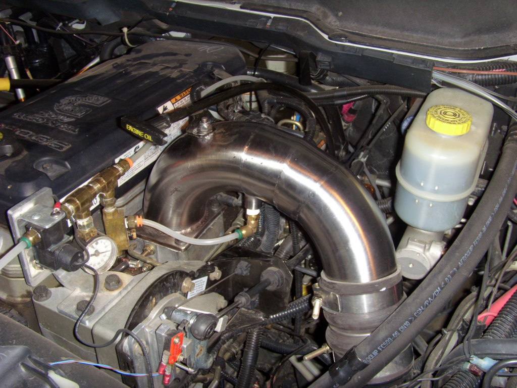

7- low restriction air cleaner and different intake from stock to improve the flow into the engine, (see pic posted here of mine I made from 3" stainless.)
