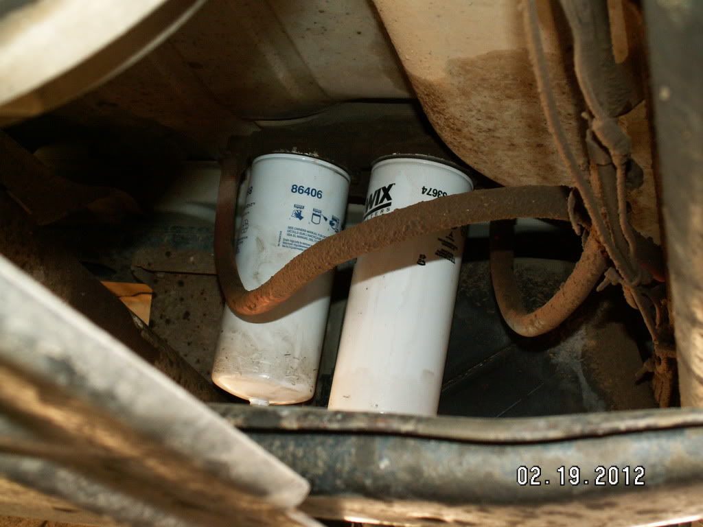

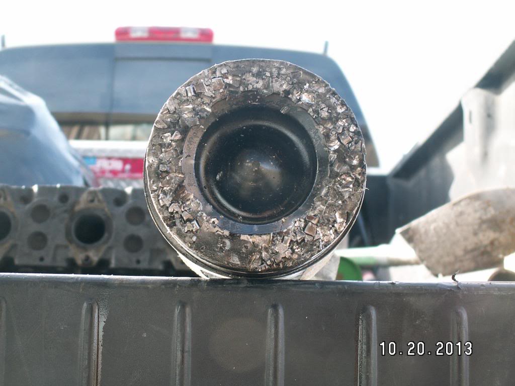

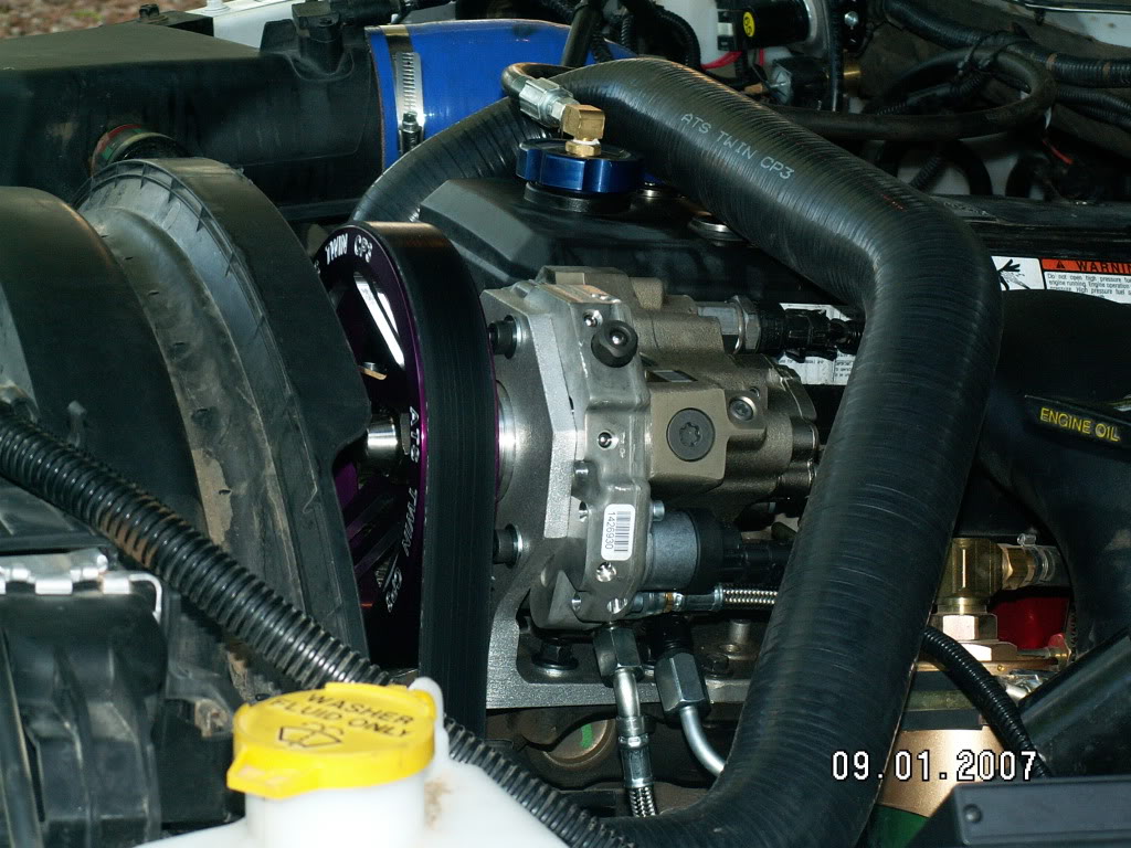

dusty the the cp3 pumps are very reliable and probably never need to be changed. the common rail is like no other injection system used in the past and virtually nothing used to troubleshoot previous injection systems applies to the cr. you tube has a great 4 part video you need to watch. we run a fleet of dodges and have our own shop and got our first 03's in 02. the bad filtering caused many injector problems and before long we understood the system better than the dealer mechanics. the lift pump on the 03 came out mounted on the filter canister, most failed under warranty (all of ours did) and were relocated to the tank we have had zero failures in the tank ones. the lift pump supplies approximately 6 psi to the cp3 if you look at the front of the engine you can find the cp3 on the right side just below the valve cover. there is two wires connected to the fca valve on the cp3, this adjusts the cp3 pressure to what the ecm asks for. at idle you see about 7,000 psi power you may see 28,000 psi surges. this go's to the common rail that has all of the injectors connected to it, the prv and the fuel pressure transducer, the pressure is on the injectors all of the time. the injectors are popped off by electrical pulses from the ecm. this answers #2. you need to add better filtering to prolong components, you can get about four times the life out of the injectors by adding the 2 micron filter. it took Chrysler ten years to figure this out and add it to the newer trucks. pm me if you want a how to for a $100 kit you can make and install in an hour. as for #1 i have never had a failure as for #3 that is a weak point. go to genosgarage.com and download there catalog or get them to send you one, they sell only the best and only for dodge and have the cheapest price. you need to fill out your sig so we know how your truck is set up, this helps us answer your questions. i usually take pictures of most failures and can post them to help. here is some, the 03 dropped a valve seat and the Chevrolet cp3 is paralleled with the truck cp3
