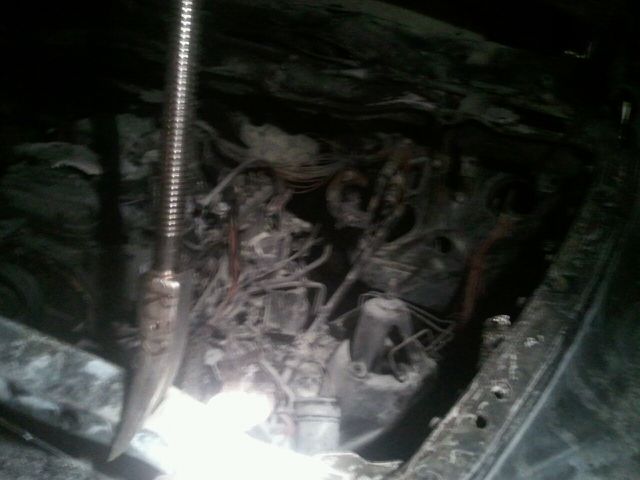

A guy I know just lost his 2003 CTD 3500 last night to a fire that was caused by the starter engaging on its own after he left the house. I have only seen this happen one other time in my carrier on a gasser, can't remember make/model. He oddly left it parked half way down his driveway so he could back his car out of the garage and take a short out of town trip with his son. Had he parked where he normally did, up close to the garage door......
At first I didn't know who's it was until he showed up later. Talk about a bad way to see an old acquaintance and having to be the one questioning him about his loss. From what he told me, the truck was completely stock except for having a bully dog pup used to tune it and adjust tire size. And he had never had any problems with the truck. I felt bad for his son as it was going to be passed down to him in a few years.
Does anyone know why or how the starter would engage itself long after the key was turned off and removed? Not just after he locked the doors, but maybe an hour or so later. The neighbor heard it cranking over constantly and was confused also. He figured it would drain the batteries and stop on its own eventually, which I'm sure it did but not before heating the cables to the point of igniting the insulation.
About the only positive thing that came out of it was that the interior for the most part was undamaged, and he was able to retrieve some valuables from it. I had a problem with whatever piece of magnesium is used for the steering column that passes through the firewall until I switched to a 30 pound dry chem and got it all out. Why do they have magnesium inside there anyway?
Just wanted to reach out to you guys and hear of any explanations I could pass on to him. Thanks.

My first thought would be that the starter relay failed and melted closed. Next on the list would be attempted theft, then road debris that contacted the starter.
It could be almost anything. Let us know if you find out.

I first thought somebody was trying to steal it also, but all the doors were locked. I had a hell of a time breaking the glass to unlock the doors and protect the interior. Didn't have my window punch with me, but finally got it with the halligan bar. I did ponder if someone had a grudge against him and maybe crawled underneath to short out the solenoid wires. No way to tell with as much damage was done. He couldn't think of anybody either.

It is remotely possible that the bendix gear caught on the flywheel or didn't fully disengage. Had that happen at work on a 3516 Cat. It was an air starter but functionally little different than an electric one. Made a lot of heat running at excessive speed and did it very quickly!

I'm wondering if it had a short in a bundle somewhere and as those wires heated up and melted insulation, more and more copper was exposed, eventually connecting randomly to charge the starter. If so, as the neighbor heard the starter going, the damage had already started (pun intended).

When I was a kid I had a 1969 Datsun 510. I was driving on a highway when I smelled burning plastic and hot oil, and the oil pressure dropped to 0 on my mechanical gauge. Turned out the starter engaged while driving, but I didn't hear it because of the very loud exhaust. The positive battery cable heated up and started burning and burned through the plastic oil line. A postmortem on the started showed that the moving electrical contact in the solenoid had broken in half and shorted the two stationary contacts together causing the starter to run.
