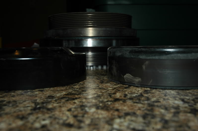

Papaduck. help a brother out here! I picked up the parts for the 6.7 upgrade this AM and after I opened the boxes, I had a brain fart! . Is the reason I'm changing the 5.9 fan pulley to compensate for a larger diameter of the 6.7 damper? As I'm writing this, I'm feeling like "why am I overthinking this, just swap the parts"!

The reason you are changing the fan pulley is the diameter of the fluid damper is larger by about 3/4 inch. The fan pulley is the same as the old one but it has an offset that allows it to clear the damper. Look at both pulleys and you can see the differance.
You're right, I guess I will have to see them side by side.

Momma always said "Be careful what you wish for"
Thanks, Guns
