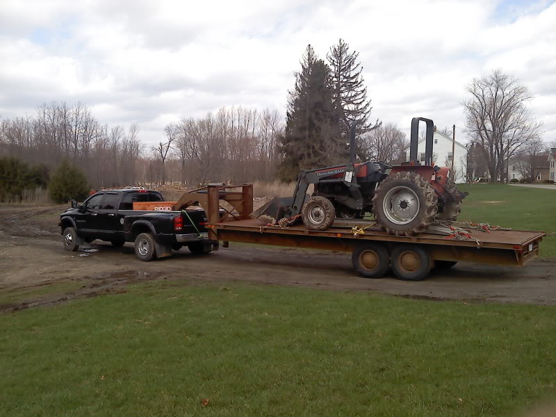

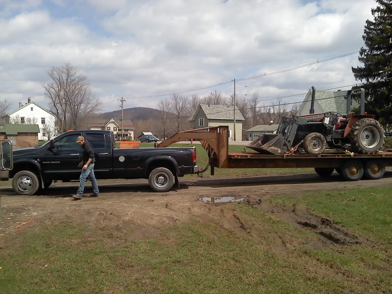

well decided to take advantage of a rainy day yesterday and get some stuff done to prep truck and trailer for the first heavy voyage with the new rig.
first of all, just like to say thanks to you folks who helped me out! picked up a new thermostat for the truck and checked the fan clutch plug. got everything done, mad sure lights and brakes where working on the trailer, and headed to NE PA to pick up a tractor for a buddy today. trailer is 6K empty, and the tractor weight around 7K. even with the hills of souther tier NY, the truck never rose over 197 degrees! everything is working the way it should be.
but on another note, my egts were running around 800 cruising on flat land, 900ish on mild hills, and around 1200 and pretty steady on the good long draws, but would hit around 1300 is i had to get into it for a short time. is this right around where they should be for these new model's? the numbers were with the juice on tow setting.
