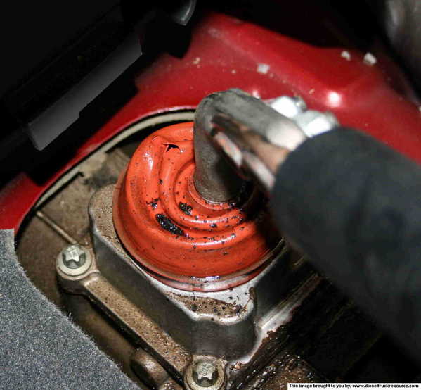

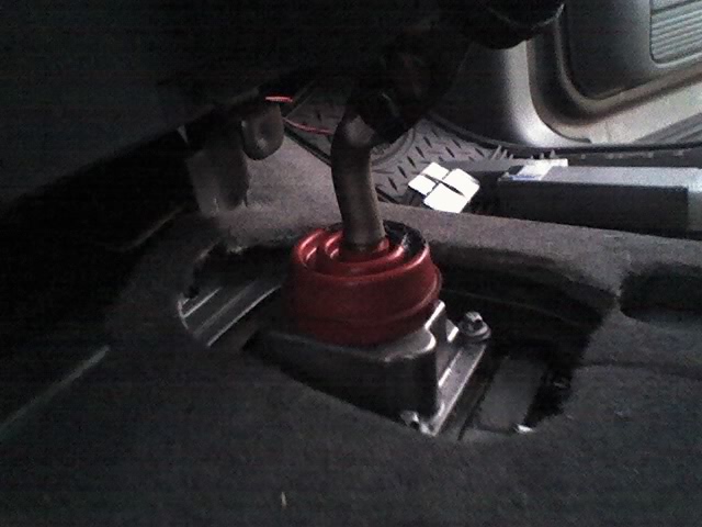

Guys, if you have G56 trans and are seeing a little leakage from it check this out. Mine started leaking right after the 3 /36 warranty was up. While getting some work done at the dealer the tech noticed the leak, and had the trans expert give a diagnosis. Since the leak was coming from the top of the trans he said it was the shift tower seal. I agreed and left it at that cause it wasn't leaking bad. I stopped by the parts department at my dealer and tried to find this seal and it doesn't exist so we figured it is just RTV sealed. Today I pulled the interior apart and found the problem, it is not the shift tower seal, it is the shifter boot. It is made from very thin rubber and it had a tear in it. I called for parts and found out this part is on national back order! Tried another dealer just to keep the first one honest and got the same info. Well red neck engineering will have to suffice, I got some balck RTV and "mended" the tear. I am waiting for it to cure while I write this. I have attached some pics of the culpret. Sorry about the crappy quality pics.

Mine has a larger boot that wraps partially up the stick under the leather boot. It acts more like a sound deadener as it wraps the lower part stick tightly. Is yours the same and just out of the picture? I haven't seen a leak yet. 47K now.

Yup, actually 2 more boots. The bigger rubber one and the faux leather interior trim piece. That little orange rubber one keeps the tranny all nice and sealed. It looks to me like it was torn during installation, because there is nothing near it that could tear it once assembled.

I just had the same thing happen to me. Only mine has two holes, one on each end of the stick. The photo below shows the one on the engine side of the stick. I'm surprised to find that this is the only thread on the subject on the whole WS. I too had to redneck engineer the thing until a replacement arrives.
