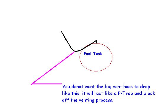

Where did you run the hose when you relocated the main vent? Also, you do not want the main hose to have a drop in it, it will get fuel in it and plug it up, sort of like a "P" trap on a sink.
On the two small vents, I ran a hose between the two with a "T" in the middle and then a hose off the "T" up the filler hose and through a hole, I drilled in the plate that holds the filler behind the fuel door.
