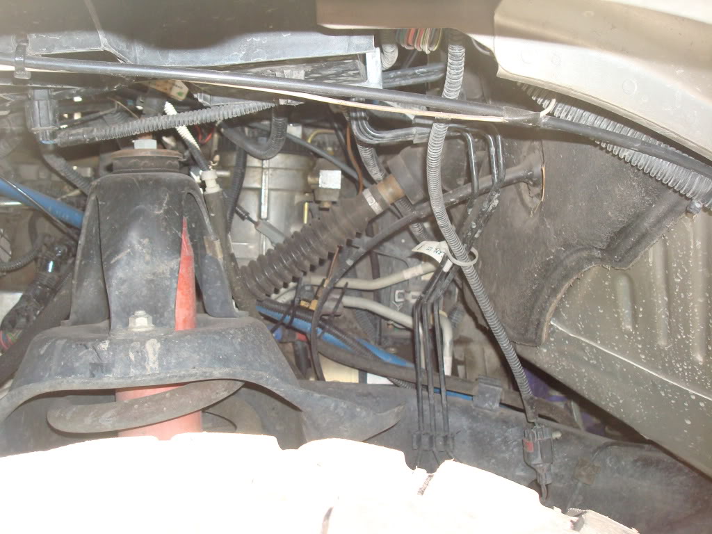

Nick, did you buy the truck used?
To check this, remove the fender well and look on the back of the fuel filter canister. In the pic below, I have the fuel pump removed, it is where the silver block is...
AFAIK, the canister mounted pump was on the 03-04.5's.

Yup. I can see it on the side of the filter canister. Plus when changing my fuel filter in the past, that's where the sound came from while priming.Thanks!
Just wanted to thank you guys for the all the advice and tips. Removed tire and fender well and whole job took an hour. Truck is running fine and all is well.
