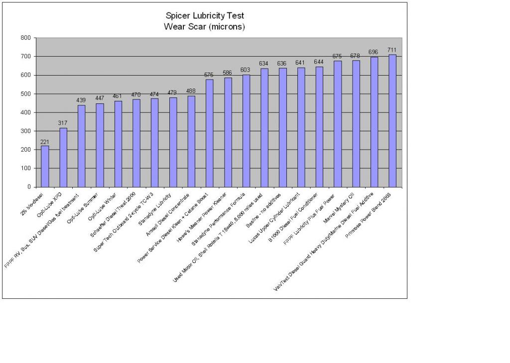

Finally found the chart...this was a study conducted by Arlen Spicer and published in depth at Diesel Place.com. If you're interested in the entire .pdf PM your e-mail and I'll send a copy.
I've used the Opti-Lube XPD, and it smoothed the engine out quite a bit, but I got no mileage gains and it was so inconvenient to purchase (shipping to AK bites) that I've not bothered to use it anymore. For day-to-day I use the Power Services gray bottle in the summer and the white bottle in the winter. Never had a gel or water issue, and when you're going from a heated garage to subzero temps every day, that's more difficult than many realize.

There was a study done that was posted in 2007 on The Diesel Place. Just found the link.
http://www.dieselplace.com/forum/sho...d.php?t=177728
The Two Stroke oil was way up there and Lucas was way down there.
