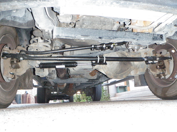

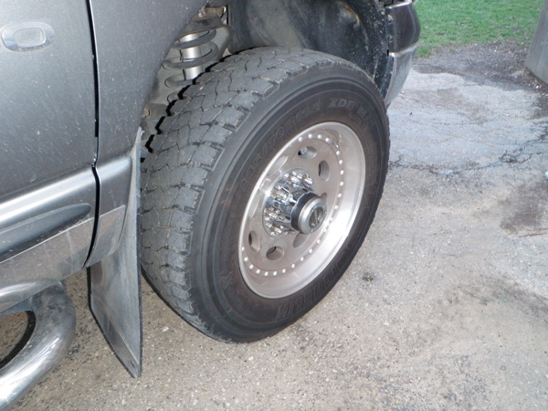

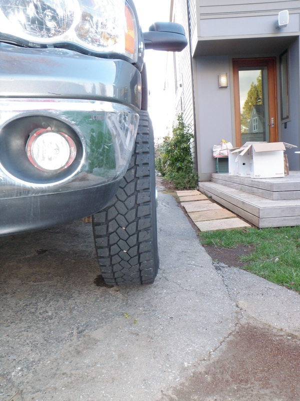

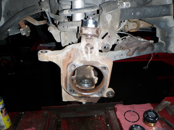

Upgrades installed
I've finally gotten all of my new front-end components installed. By the looks things, I think my timing was pretty good too... In addition to the rattling ball joints (which I knew about), I discovered that the passenger side unit bearing was in bad shape. It is nearly impossible to spin by hand and feels gritty; I have no idea how long it has been like that or how much longer it would have continued working. The driver's side bearing feels dry, but at least it spins. Anyway, I'm glad that I have serviceable bearings there now.
At Dynatrac's recomendation I went with U-joints from PowerTrain and while I was at it I put in a set of AutoZone Severe Duty brake pads (my original pads had 87K on them, a real testament to my PB exhaust brake!). Of course, I followed up with a front end alignment too.
The truck drives GREAT and the front end and steering feels better than new. The most noticeable thing is that the steering effort much easier, especially at slow speeds in tight spaces... this makes it feels like it has a reduced turning circle (I don't think that's actually the case). Also there's definitely reduction in driveline vibration. I've only driven a few hundred miles so far so I don't know if there will be any improvement in fuel economy... I can say that I have seen a 3-5 MPG jump on the overhead lie-o-meter but I don't have any idea if that will translate to a better number when I hand-calc'.
Here are a few pic's:
Dynatrac ProSteer ball joints installed.
My Vision wheels are zero-offset so the Dynaloc's just barely stick out wider than the tire.
'08 Mopar steering upgrade.
Cheers
-Mark
