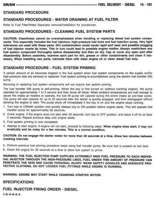

Came across this in the '05 CTD service Manual and thought it might be helpful for some 'first-timers'.

Thanks. I was sitting here looking up what parts I'd need to replace the filter this weekend, and was beginning to wonder how I could prime the system. This will help me complete the job!

Thanks for posting that. I have changed my fuel filter out a couple of times and found some good directions then. This will really help the new guys who are looking for info.
