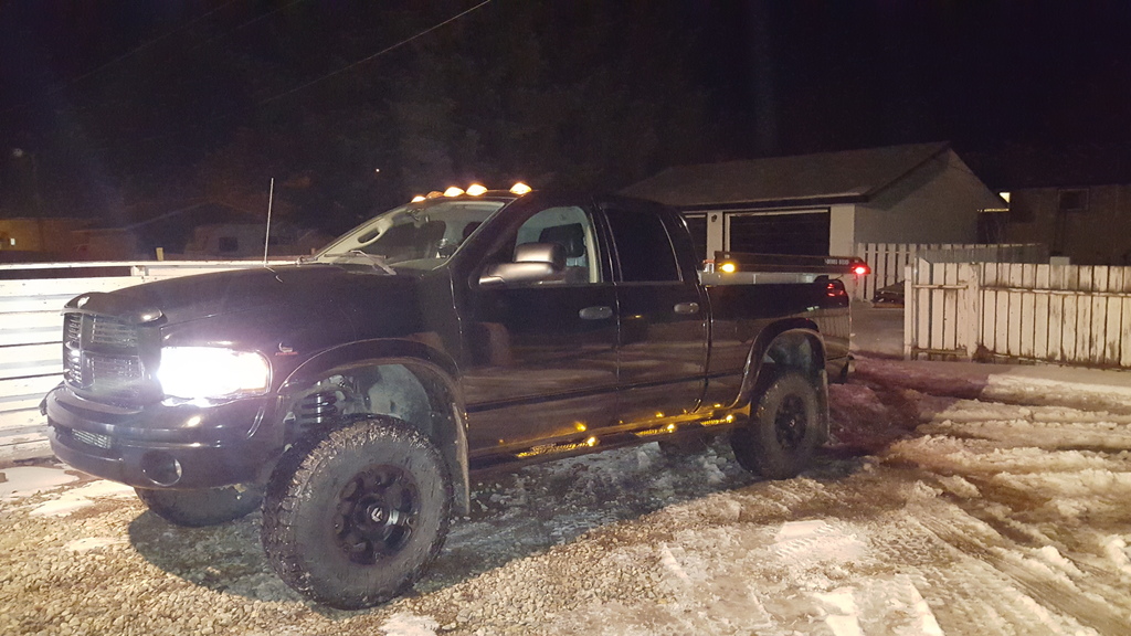

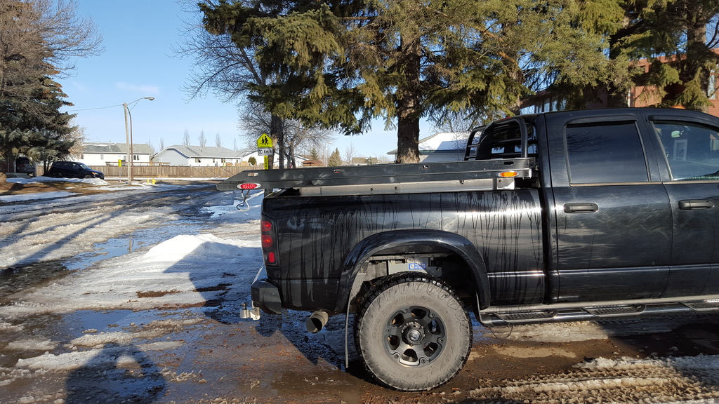

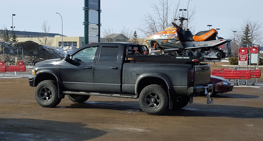

Sounds like you got big tires on there? Got a pic? Love to see it. You really need 4WD up there. Are you from SK or AB? My relatives are all from SK, Estevan, and Regina. Now they all live in Calgary and Edmonton. Too cold for this social kid
I am northern sask born, still live on the sask side but ony by 1/2 mile. I live just off the ab/sk border (lloydminster, border town).
I drive in the BC mountains and haul sleds around so 4wd is pretty much mandatory.
I dont have many pics of it but here are a few:
Nice truck. I really like the step bars that extend all the way into the bed. I gotta do more growing just to reach the back of the bed. The newer trucks are tall. Is the ride pretty rough on the solid front axel? The one I am looking at is the Laramie long bed with 4 doors.
It rides pretty good now but i put a full Carli 3" pintop suspension kit into it (cost alittle over half of what i paid for the truck, ouch!)
It still rides better than my 1st gen did, but it was a 4wd also.

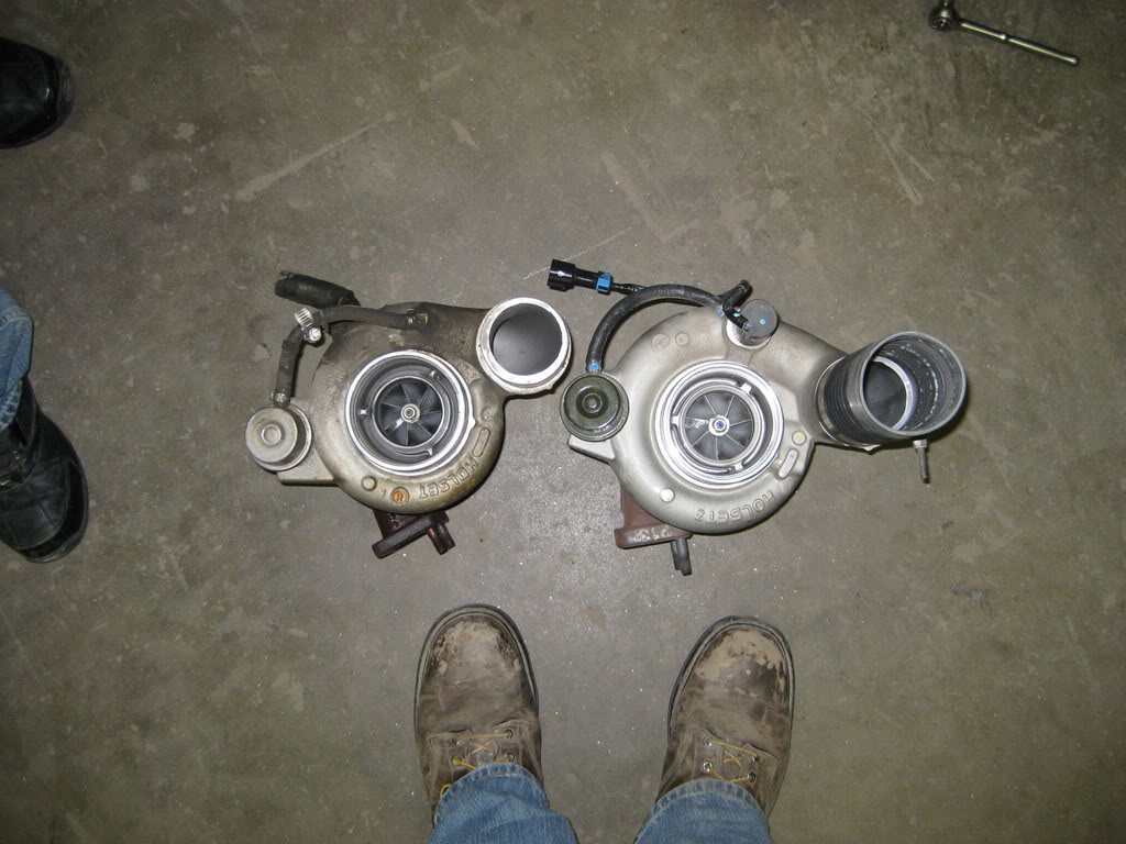

Look at the turbo, an 04.5 truck will have an electronic solenoid threaded into the compressor housing. 03-04 trucks do not have this solenoid.
The black piece with wires in this photo is the solenoid:
