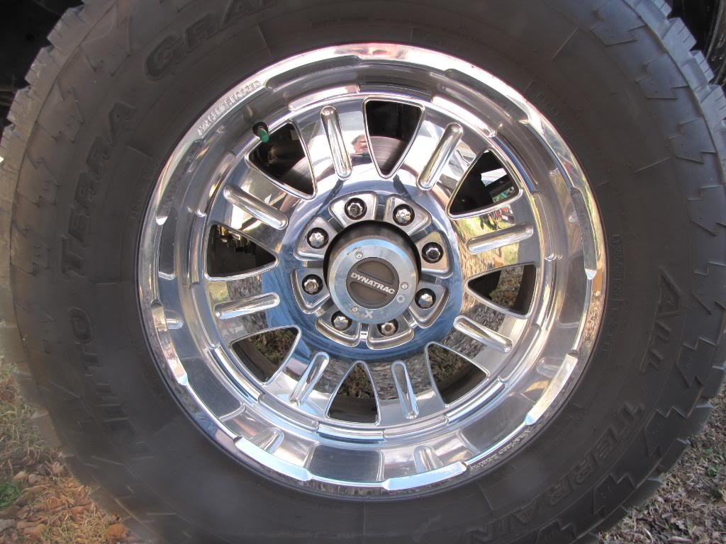

I haven't noticed any milege improvements, would've been nice and I'm supprised I didn't (although I did do a gear change and air lockers at the same time). The main reason I went with them is I know there is a lot less wear and tear going on now and can be worked/bearings greased on when needed. If you know your going to need 4x4, just lock'm and leav'm till your done or out of the area your in.

Looks good! Hopefully you dont loose your lug locks LOL!!

Thanks, and I hope I don't!!!
