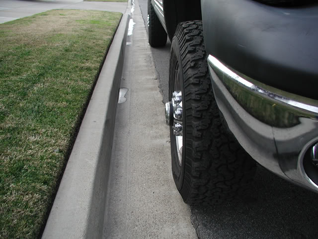

And to answer the original question the Dynaloc hubs are way stronger than the Warns and a neat part of the design is that if they do fail they default to the locked position as opposed to unlocking. Generallt when your in a situation that would break a hub you are also in desperate need of 4wd.
Here are pics of how far the Warns stick out as opposed to the Dynalocs:
