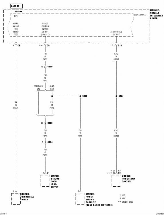

Like I said before....the circuit breakers are self resetting. If you had a direct short to ground, there would be smoke every time the circuit breaker would try to reset! I doubt that is the problem. I would look in the ignition switch area next, or wherever you made the connections for your guages. If you used a wire tap product, I've seen those things cut the wire in half. Otherwise look at the wires coming out of the ignition switch. I'll get the wire diagram for ya in a minute.

Here.....
https://www.dieseltruckresource.com/...1&d=1197862057
