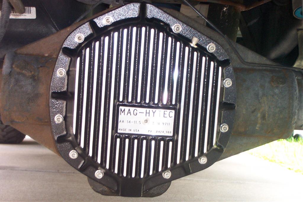

I'm really old-school about diff lube. I had a 97 D80 that ran blazing hot and didn't cool down or have good uoas til I used 85w140 and a Mag cover didn't help but the Dana Mag cover had the fill hole higher so the wheel brgs would get plenty of oil, which I liked. Does anyone know how high the fill hole is in the Mag covers for the AAMs? I run 5 qts of 85w140 in my 03 and the temp is the same, no seal leaking and the uoa is very good. Craig

C Shomer, here's a pic of my Mag-Hytec cover that I just put on not to long ago. Upper right of the cover about the one o'clock position is the dipstick/fill hole. Took 8 quarts to fill.

Chris, is the oil level higher with the Mag cover than with the stock cover? Thanks, Craig
