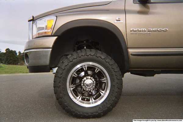

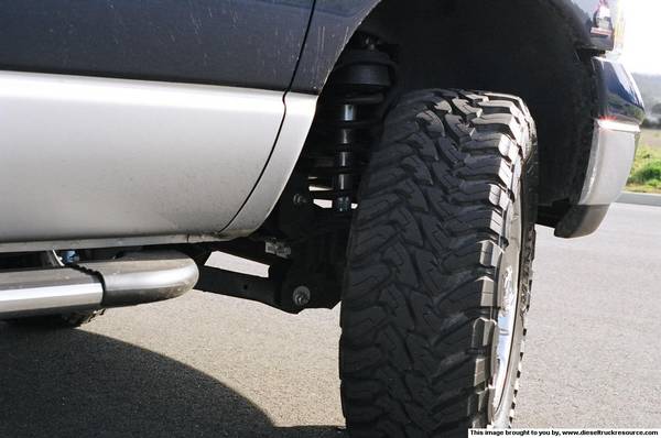

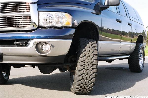

Menzy, a few memebers give you the right answer, your 4.5 wheels are just to much to the outside without a giant lift.
Here you go 35"s with leveling kit and a 5.5 back-space.
[IMG][/IMG]
[IMG][/IMG]
[IMG][/IMG]
The next one is a 4.5" lift and would not work unless a 5.5 back-space with a 9" wide wheel.
[IMG][/IMG]
