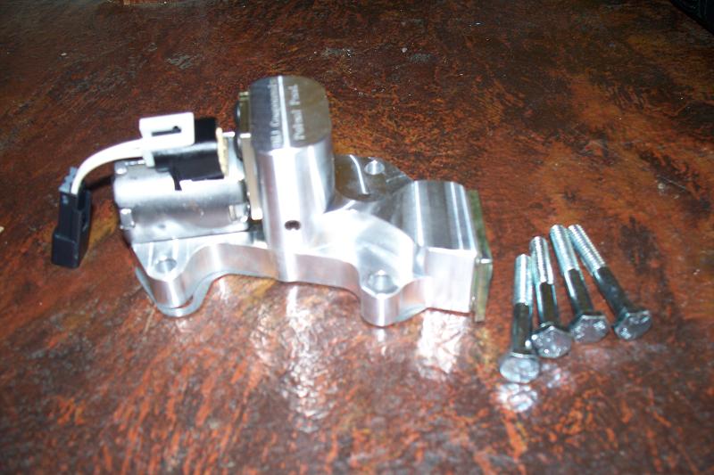

Here you go.... Be nice, now.
Similar, but more like second pic!
Attached Thumbnails Did I get the right pressure solenoid?-gm-governor-solenoid.jpg   Did I get the right pressure solenoid?-gm-governor-solenoid-2.jpg
Thats looks more like the Suncoast unit with the BorgWarner solenoid. The PATC has striations on the flat pieces and the other doesn't.
I was told DTT was using the Borg solenoid and it looks like it to me.
