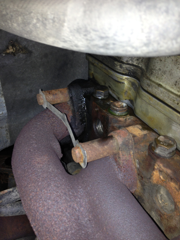

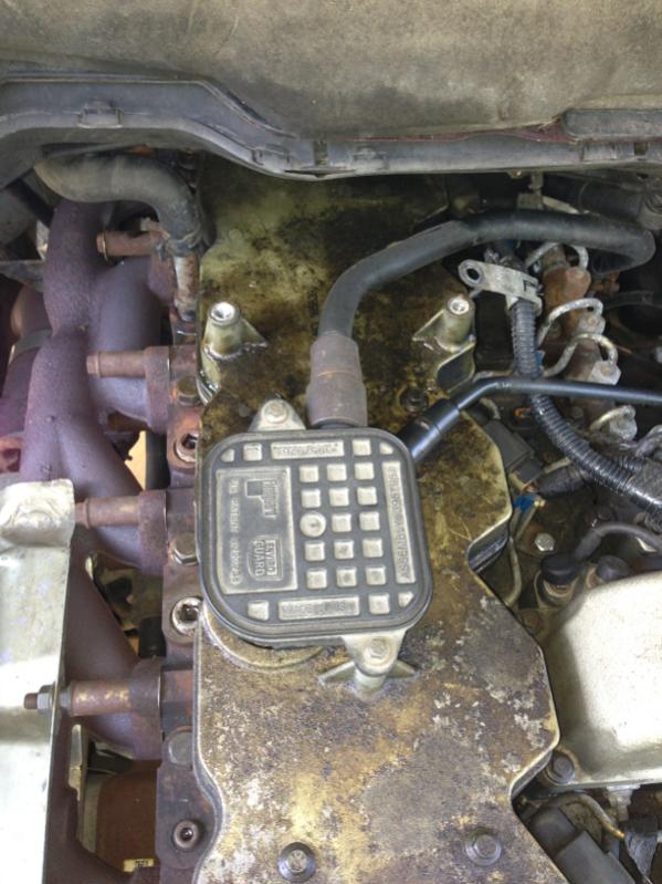

I have been having a mysterious coolant leak for a little while. I put a hose clamp on the overflow already but that was not the issue. I havent changed the radiator cap but it doesn't look like there is much if any coolant leaking from there. I have no puddles under the truck ever. This morning I opened the hood to check it out and this is what I found. The whole back of the motor is coated. I dont think this looks good but how do I trouble shoot from here? No smoke, runs fine.

Try washing it down as clean as you can get it and let it dry then run down a few blocks until its warm pull over with a flash light and take a look its had to tell from just pictures and it looks like it leeks under pressure. Or if you have a way to pressure up the rad after you wash it down???

I think I found what was all over the back of the motor. I already ordered a new crankcase filter. I don't think this would cause a coolant leak though?

Are you sure it's coolant that's leaking?? Most times a mess like that around the valve cover is either oil or fuel. Like stated, give it a real thorough cleaning and go from there. Keep us posted.

It looks like that pipe plug in the back is about to fall out. Wouldn't hurt to put a wrench on it and see. All the stuff on the right hand side looks like just oil. Don't forget about that little hose under the exhaust manifold when you start looking for leaks, it has been known to leak.

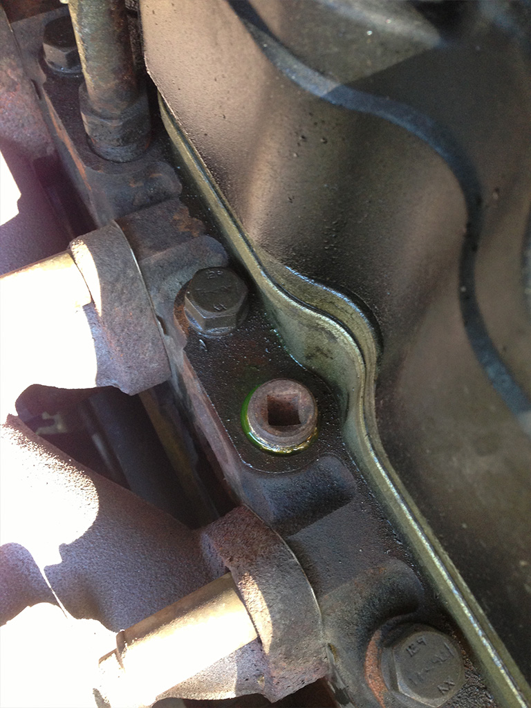

I took it for a ride this morning and here is the only spot coolant showed itself. I'm pretty sure it's coolant. It's neon green. It seems to be showing up around those lugs? What are those lugs exactly?

I am guessing that you wanted to type "plugs"? Those plugs are coolant passages in the head, they are just like the one with the nipple in it for the heater core. They will have coolant under them.

I did mean plugs, thank you. Is it possible that I just need to reseal, replace? If so, what would be the process to do so?

Teflon tape or pipe dope works well. Pipe threads have a taper so they will get tighter as they go in. I would try to snug them up first and see how that goes. If they still leak pull them out and try the teflon tape. If you pull them out you may loose a little coolant, not much as they are very close to the top point in the system. A 3/8 ratchet or extension will fit in those plugs.
