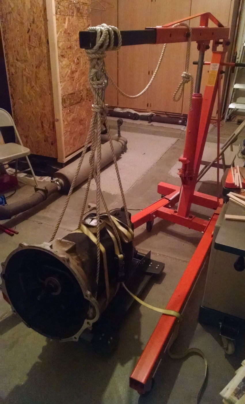

Now for the big adventure part. I got a low lift 800lb transmission jack from harbor freight for this job. It worked okay to remove the transmission. However, when I was getting the transmission back in place, I was turning the side-to-side adjustment **** when the darn jack CAME APART.
In 0.0000001 seconds the transmission flopped sideways and pulled the jack right over with it. It came to rest with the front end up against the exhaust pipe, the back end pointing down, and all the oil draining out onto the driveway. On the plus side, because I used a ratcheting tiedown strap to attach the transmission to the jack (thanks for the tip, guys), the case never actually hit the ground.
As you’d guess, this made a lot of extra work. I’m incredibly lucky that my Dad was available and he helped me a great deal from this point on. He’s very creative and knows heavy objects, which was invaluable in working with that giant transmission. Anyway, it was clean up the oil, get the transmission onto a dolly, jack the truck way, way up, roll the trans out from underneath, use an engine hoist to get the trans back onto a new jack, roll the tans back under the truck, lower the truck back down because the jack won’t lift it high enough now…

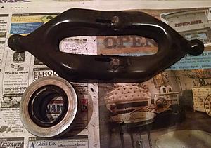

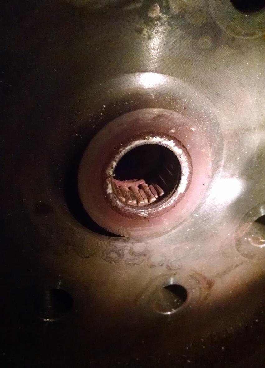

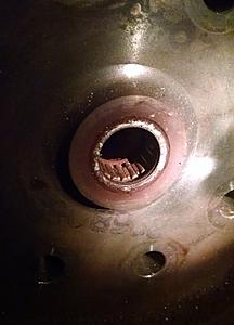

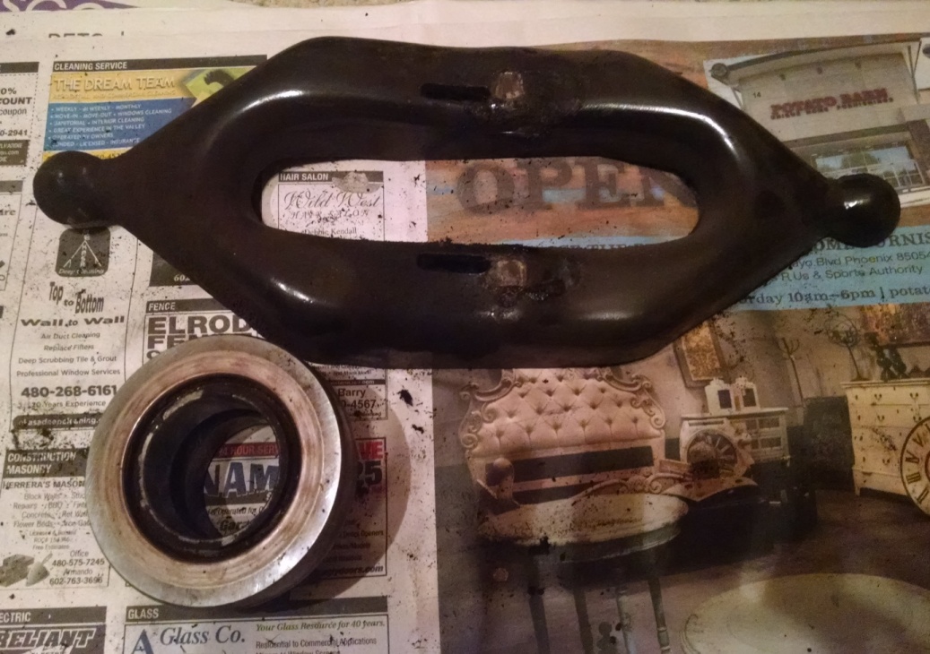

And finally onto the pics. In my case, it looks like a bad throwout bearing was the cause of the irritating whining sound. I couldn’t turn at all, holding it in my hands. You can see the groove in it and the flat spot it rubbed into the pressure plate. I also took a picture of the dry, rusty pilot bearing.
